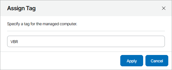

  1. In the Assign Tag window, specify a tag that must be assigned to a backup server and click Apply.
