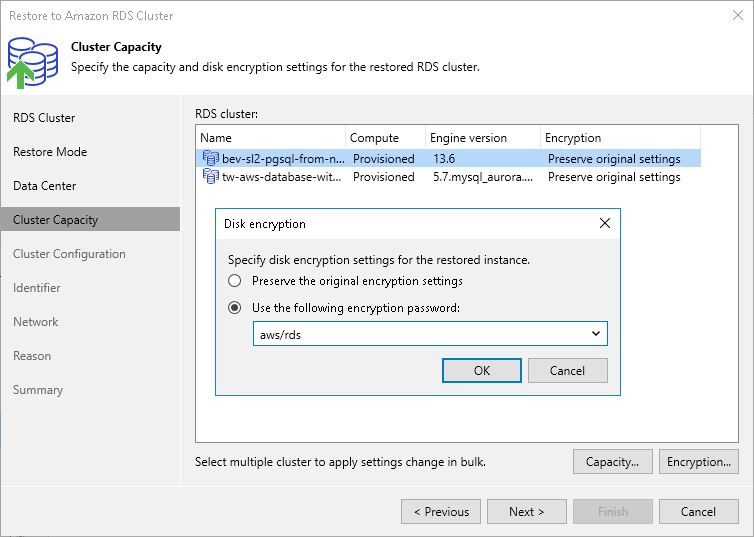

Step 6. Configure Capacity Settings and Encryption
Configuring Encryption
Before you configure encryption, check Limitations and Considerations.
To specify encryption settings, do the following:
  1. In the RDS cluster list, select the necessary clusters and click Encryption.
  2. In the Disk encryption window, do one of the following:
  • If you do not want to encrypt the RDS resources or want to apply the existing encryption scheme, select the Preserve the original encryption settings option. Then click OK.
  • If you want to encrypt the RDS resources, select the Use the following encryption password option. From the list of available KMS keys, select the required KMS key. Then click OK.
