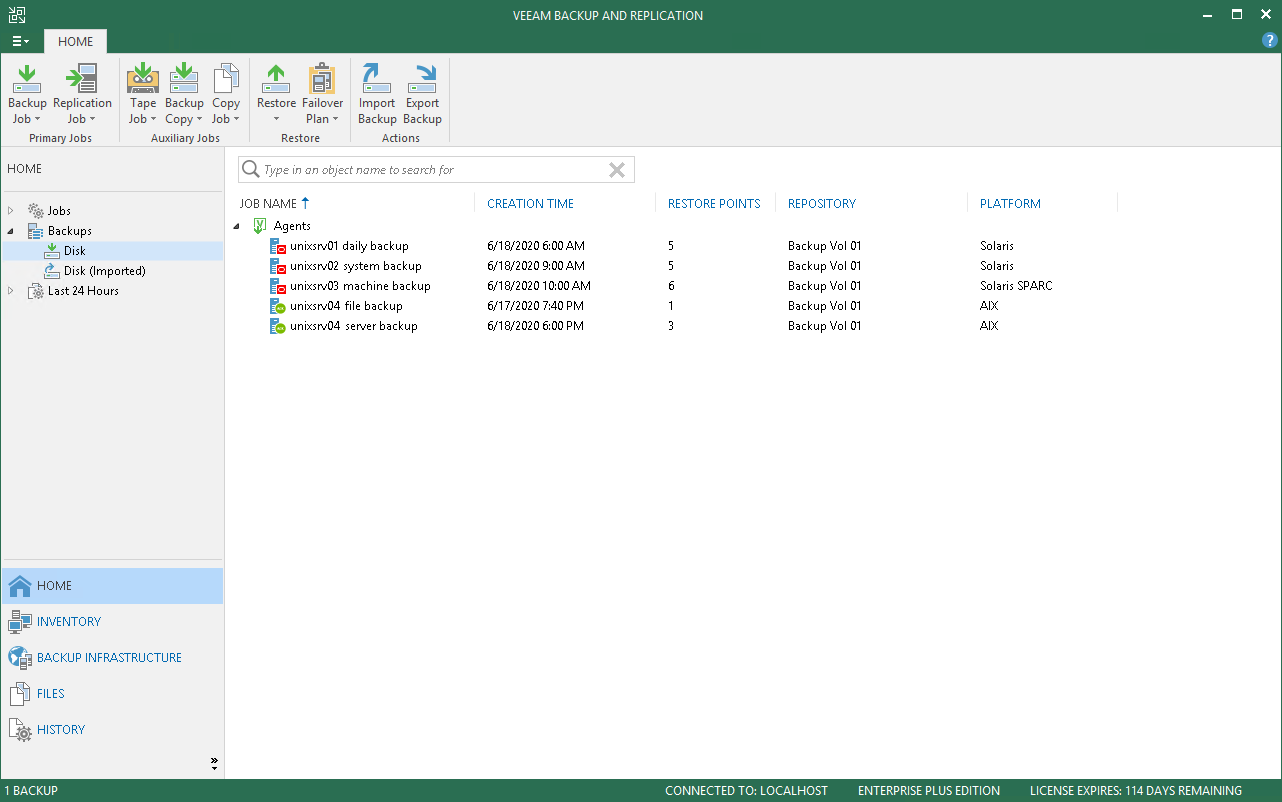

Information about Veeam Agent for Oracle Solaris backups stored on the Veeam Backup & Replication backup repositories, backup jobs and sessions becomes available in the Veeam Backup & Replication console:
- The Veeam Agent backup job is displayed in the list of jobs in Veeam Backup & Replication.
- Backup files created with Veeam Agent for Oracle Solaris are displayed in the list of backups, under the Agents node.
- Performed job sessions are available in the History view of Veeam Backup & Replication.
