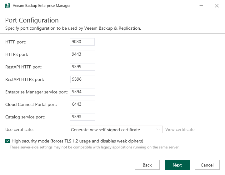

When you are running the Veeam Backup Enterprise Manager setup wizard, you can specify a port for connection with the REST API service. The default HTTPS port is 9398. During the installation, a self-signed TLS certificate is created and bound to Enterprise Manager, the REST API and their ports.

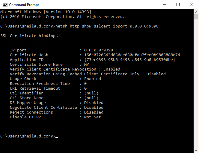

To view the TLS certificate used for the REST API, enter the following command in the command line:
netsh http show sslcert ipport=0.0.0.0:9398
