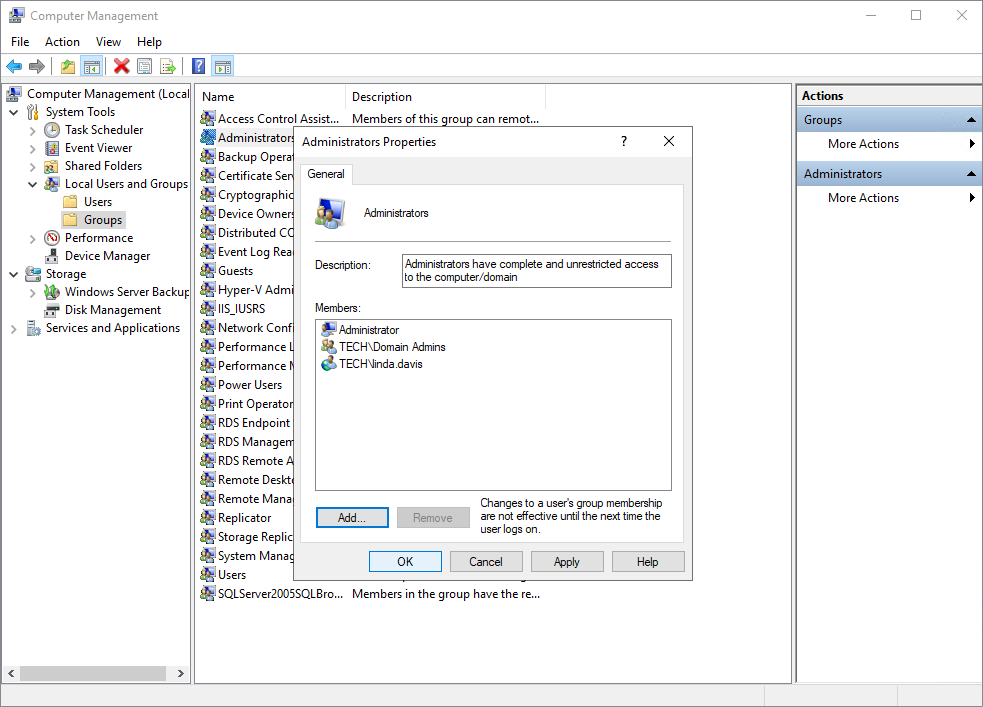

  1. Log in to the VM whose guest OS files you plan to restore. Make sure that the user account under which you plan to perform self-service restore is added to the local Administrators group on this VM.
Check Local Administrators on a VM

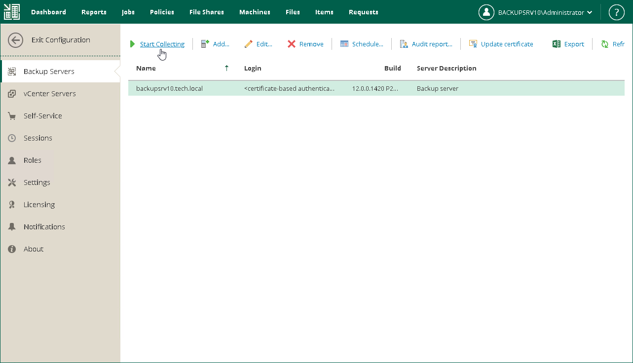

  3. At the top right corner, click Configuration to open the Configuration view.
  4. Select the Backup Servers tab. In the working area, click Start Collecting.
Veeam Backup Enterprise Manager will collect data about jobs from the backup server. To check whether collecting data finished, click the Sessions tab. Make sure that the data collection session has completed with the Success status.
Collect Data from the Backup Server

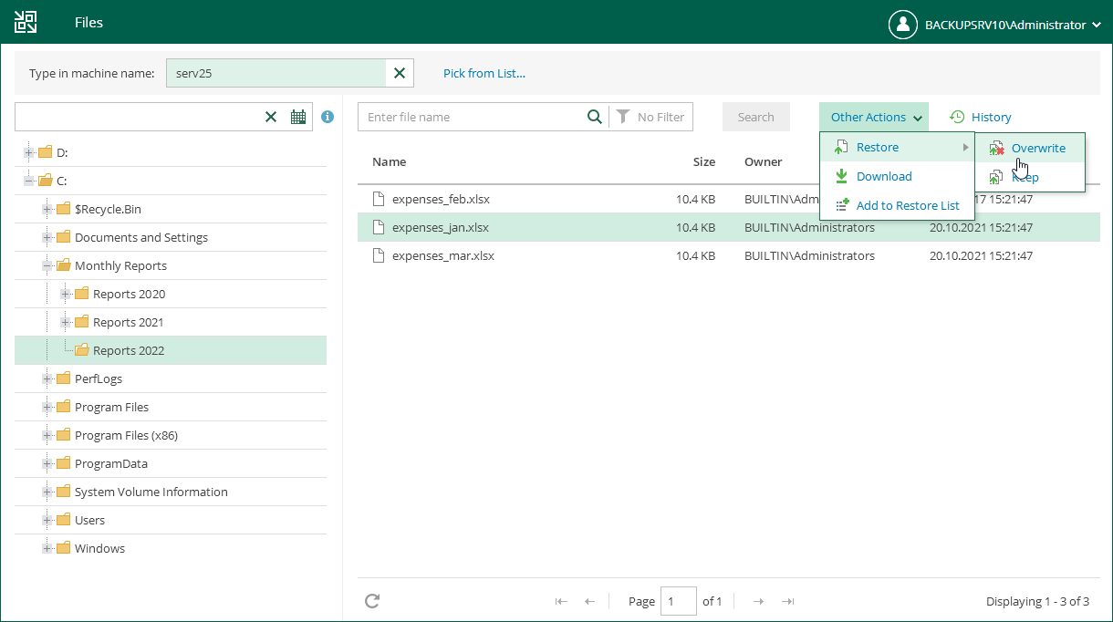

  1. On another machine, open a browser and use the following address to access Veeam Self-Service File Restore portal remotely:https://enterprise_manager_server_IP_address:9443/selfrestore
  2. Log in to the portal. Specify the user account with local Administrators privileges on the machine for which you plan to restore files. See the first step.
  3. The portal will display only one tab — Files. At the top of the working area, click the pick different machine link. Select the required VM.
  4. Click the field with the calendar icon and choose the restore point from which you want to restore data.
  5. At the top of the working area, click Mount.
  6. Find the necessary file or folder, select it. At the top-right corner, click Other Actions > Restore > Overwrite.
The original file will be overwritten.
Choose Files to Restore
