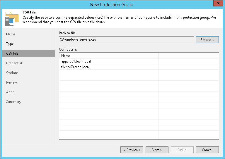

    The CSV File step of the wizard is available if you have chosen the Computers from CSV file option at the Type step of the wizard.
    At this step of the wizard, you can specify a file that defines a list of computers that you want to add to the protection group. You must specify a list of computers in a file of the CSV or TXT format. The file must be created beforehand. To learn more, see Preparing CSV File.
    To specify a CSV file:
    1. In the Path to file field, click Browse and specify a path to a CSV file that contains a list of IP addresses or domain names of computers that you want to add to the protection group. The CSV file can reside in a folder on the local drive of the Veeam backup server or in a network shared folder accessible from the backup server.
    2. In the Computers field, review the list of IP addresses or domain names imported from the CSV file.
