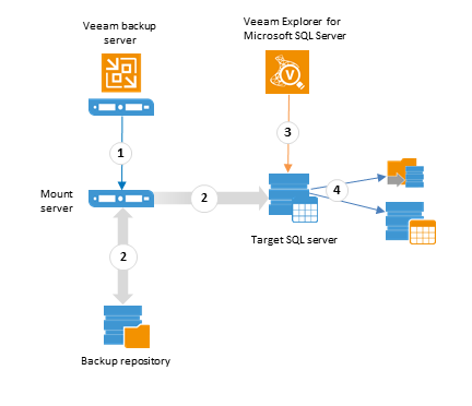

    1. The backup administrator uses Veeam Backup & Replication restore options to mount database files from the SQL Server's backup, making database hierarchy available for browsing and search.
    2. Veeam Explorer for Microsoft SQL Server obtains SQL Server hierarchy information (instances and databases) and presents it to user, facilitating browsing and search. A user selects and follows the necessary database restore scenario.
      Veeam Explorer for Microsoft SQL Server supports several scenarios that are similar for database restore and export:
    • Restore/export to current restore point (the one currently mounted to Veeam backup server)
    • Restore/export to selected point in time
    • Restore/export to the state before selected transaction.
    The first scenario involves target SQL Server only; others involve target and staging SQL Servers, as follows:

    1. Finally, the database is ‘re-created’ on the target Microsoft SQL Server and becomes ready for use. If the export scenario was used, exported database can be then attached to the SQL Server you need.
