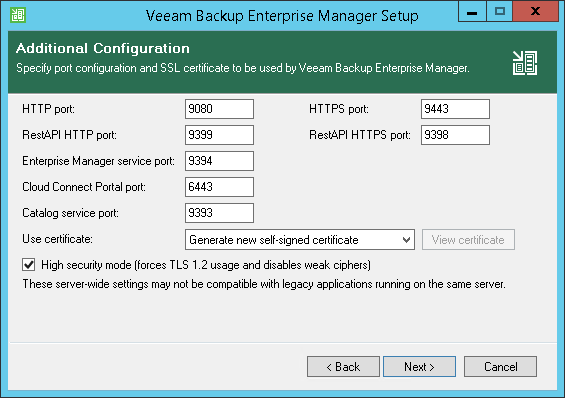

When Veeam Backup Enterprise Manager RESTful API is running over HTTPS, the communication between the client and the server is secured with the SSL protocol. For SSL connections, Veeam Backup Enterprise Manager RESTful API uses the same self-signed SSL certificate that is created for Veeam Backup Enterprise Manager during its installation.
By default, when Veeam Backup Enterprise Manager is installed, the SSL certificate is bind to the HTTPS port 9398.

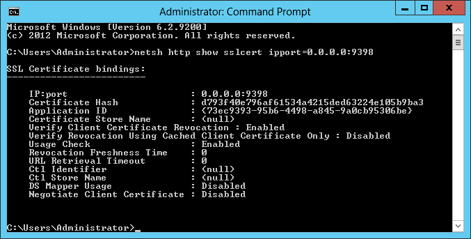

To view the SSL certificate used for Veeam Backup Enterprise Manager RESTful API, enter the following command in the command line:
netsh http show sslcert ipport=0.0.0.0:9398
