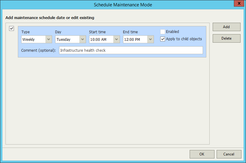

You can configure a maintenance schedule for objects in your infrastructure. When a schedule is set, the maintenance mode will be enabled and disabled automatically according to the schedule.
To configure a maintenance schedule:
- At the bottom of the inventory pane, click Infrastructure View, vCloud Director View, Business View or Data Protection View.
- In the inventory pane, right-click an infrastructure object and choose Schedule Maintenance Mode from the shortcut menu.
- In the Schedule Maintenance Mode window, configure the schedule.
- Click Add.
- In the Type field, specify how often the object must be placed into the maintenance mode (once, monthly, weekly, daily).
- In the Day/Date field, specify a day when the maintenance mode must be enabled.
- In the Start time and End time fields, specify the start and end time of the maintenance period.
- Select the Apply to child objects check box if you want to enable the maintenance mode on the object itself and its child objects.
- In the Comment field, type additional information about the schedule. You can enter up to 512 characters in this field.
- Select the Enabled check box to enable the new maintenance schedule.
The new schedule will be automatically added to list.
- Click OK.
To temporary disable a maintenance schedule:
- In the Schedule Maintenance window, clear the Enabled check box next to the necessary schedule.
- Click OK.
The disabled schedule will remain in the list, but it will not be applied to the object.
To delete a schedule:
- In the Schedule Maintenance window, select the check box to the left of the schedule you want to remove.
- Click OK.
