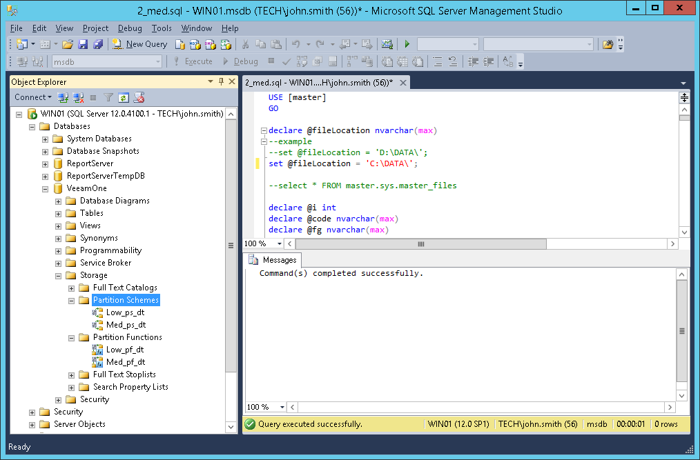

  4. In the object explorer pane, expand the Veeam ONE database > Storage > Partition Schemes and Partition Functions nodes and make sure the following nodes are available:
  • Partition Schemes: Low_ps_dt, Med_ps_dt
  • Partition Functions: Low_pf_dt, Med_pf_dt
Run Partitioning Scripts

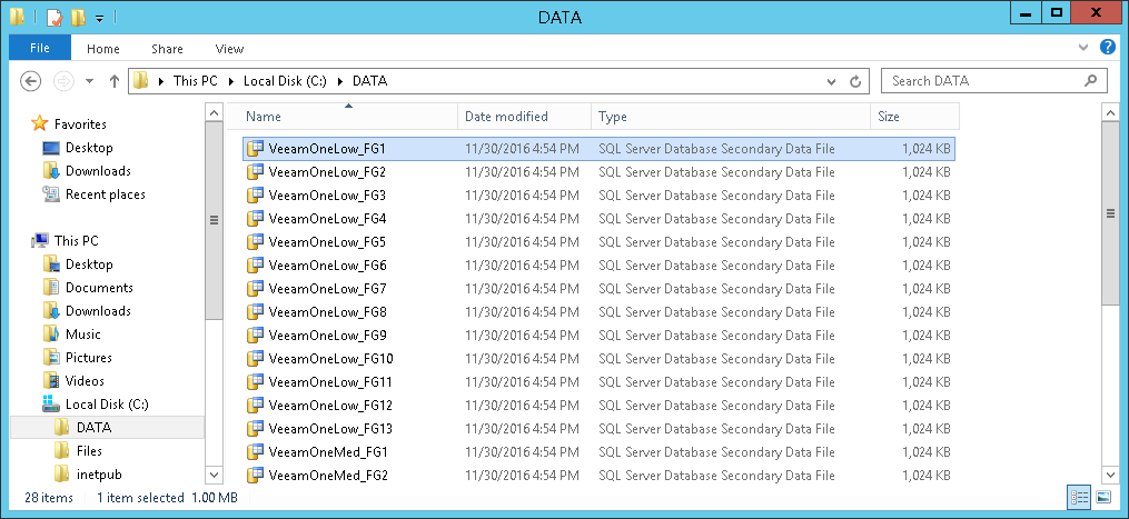

  1. Make sure that the directory with partition files includes files similar to the following:
Check Partition Files
