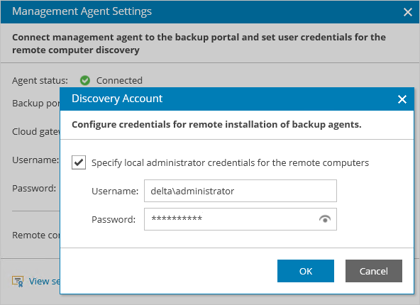

- In the master agent settings, specify credentials of an account that will be used to upload the setup file to client computers.
- Log on to a computer that hosts the master agent.
- In the icon tray, right-click the master agent icon and choose Agent Settings.
- In the Veeam Master Agent Settings window, click the Remote computer discovery user account link.
- In the Discovery Account window, select the Specify local administrator credentials for remote installation of backup agents check box.
- In the Username and Password fields, specify credentials of an account that will be used to upload the Veeam backup agent setup file to client computers.
The account must have local Administrator permissions on all computers in the update scope — that is, computers that run Veeam backup agents that must be updated.
- Click OK.
- In the Veeam Master Agent Settings window, click Close.
