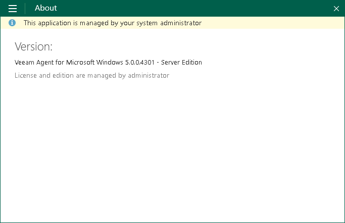

    In the managed mode, Veeam backup agent Control Panel displays the name of the service provider company at the top left corner. The About section in the Control Panel displays a notification saying that the license and edition are managed by administrator.
