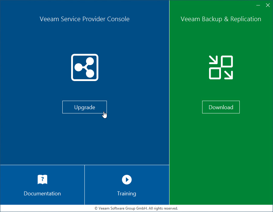

  1. Run the Setup.exe file from the image to launch the setup splash screen.
  2. On the splash screen, click the Upgrade tile to launch the Veeam Service Provider Console Setup wizard.

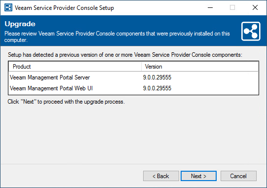

  1. At the Upgrade step of the wizard, review the components to upgrade.
Review Components to Upgrade

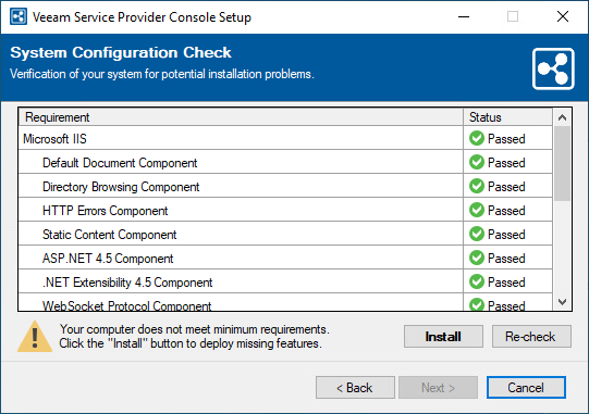

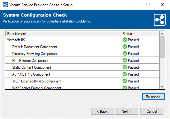

  1. At the System Configuration Check step of the wizard, check what prerequisite software is missing.
Before proceeding with the upgrade, the installer will perform system configuration check to determine if all prerequisite software is available on the machine. To learn what software is required for Veeam Service Provider Console, see Veeam Service Provider Console Release Notes.
If some of the required software components are missing, the setup wizard will offer you to install the missing software components and enable missing features automatically. To install the missing software components and enable missing features automatically, click the Install button.
Check Configuration
You can cancel automatic software installation. In this case, you will need to install the missing software components and enable missing features manually (otherwise, you will not be able to proceed to the next step of the setup wizard). After you install and enable all required software components, click Re-check to repeat the system configuration check.
Check Configuration

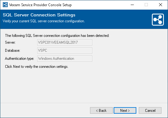

  1. At the SQL Server Connection Settings step of the wizard, check settings of a connection to Microsoft SQL Server instance and Veeam Service Provider Console database.
Check SQL Settings
Note:
If your infrastructure contains products with unsupported versions, Veeam Service Provider Console will display a warning and upload the list of unsupported products to a temporary folder. It is recommended that you upgrade these products before you upgrade Veeam Service Provider Console.

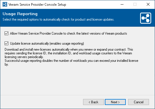

  1. At the Usage Reporting step of the wizard, configure license usage reporting settings:
  • If you want Veeam Service Provider Console to automatically check for managed Veeam products updates, select the Allow Veeam Service Provider Console to check the latest versions of Veeam products check box. When a new product build is published on the Veeam update server, a notification will be displayed in Veeam Service Provider Console.
  • To install new licenses automatically when you renew or expand your contract, select the Update license automatically (enables usage reporting) check box. If you enable the automatic license update, and therefore enable usage reporting, you will double the number of workloads by which you can exceed your installed license. For details, see section Exceeding License Limit of the Guide for Service Providers.
If the automatic license update is enabled, Veeam Service Provider Console will automatically send license usage statistics to Veeam License Update Server. For details, see section Automatic Usage Reporting of the Guide for Service Providers.
Note that for Evaluation and NFR licenses automatic license update must be enabled. For details on license types, see section License Types of the Guide for Service Providers.
Enable Usage Reporting
