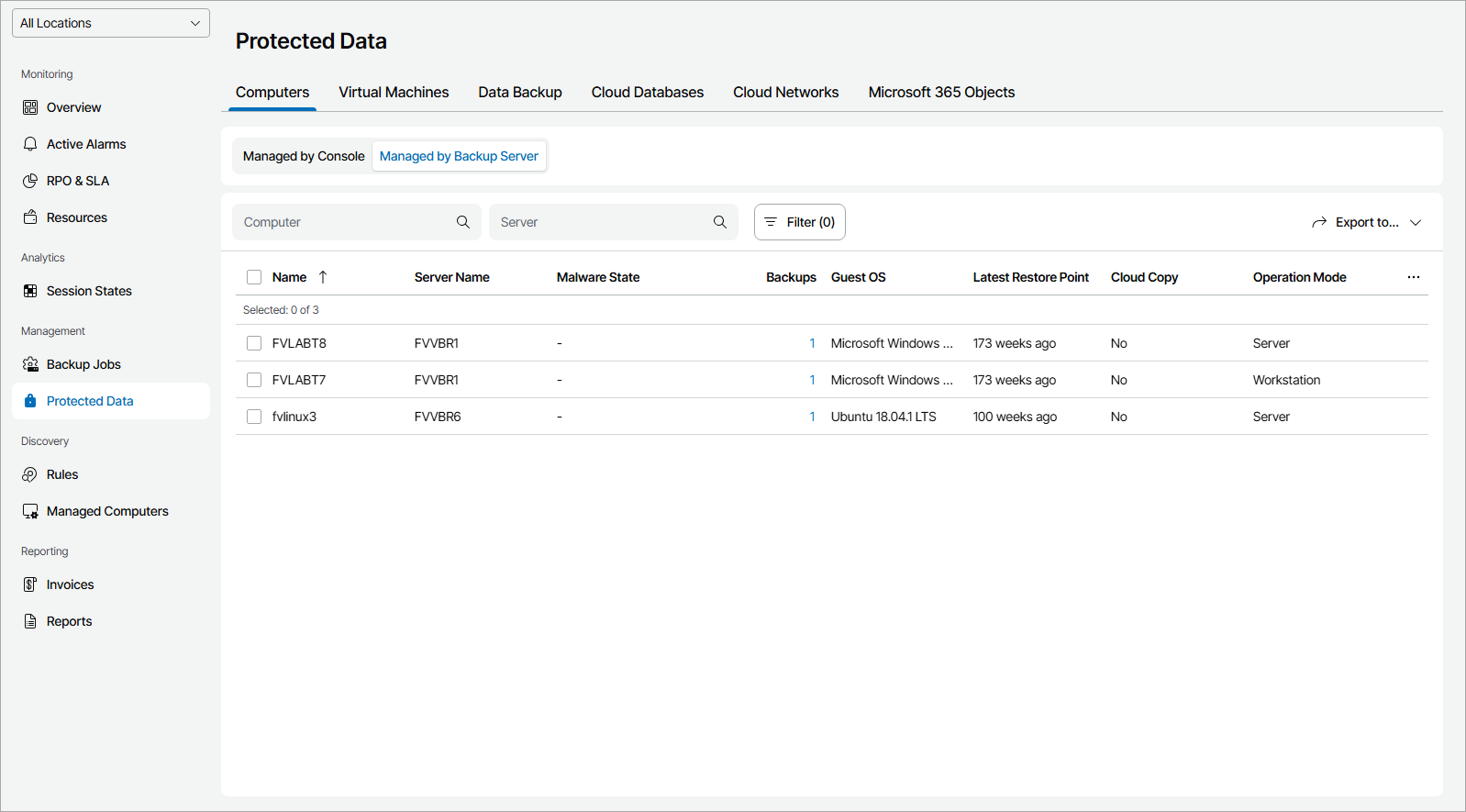

To view and export details of Veeam backup agents protected by Veeam Backup & Replication:
  1. In the menu on the left, click Protected Data.
  2. Open the Computers tab and navigate to Managed by Backup Server.
Veeam Service Provider Console will display a list of all managed Veeam backup agents.

  1. To export protected computer details, click Export to and choose a format of the exported data:
View Protected Computer Details
Each protected computer in the list is described with a set of properties. By default, some properties in the list are hidden. To display additional properties, click the ellipsis on the right of the list header and choose job properties that must be displayed.
If a job is assigned to your company by the service provider, some properties may be unavailable.
  • Name — name of a protected computer.
  • Server Name — name of a backup server that manages Veeam backup agent.
  • Malware State — antivirus scan result of the created restore points.
Note that to view the antivirus scan result, you must connect to Veeam Service Provider Console the Veeam ONE server that monitors the backup server.
  • Backups — number of backup jobs configured for a computer.
You can click this property, to view and export backup job details. For details, see Veeam Backup Agent Job Details.
  • Backup Copies — number of backup copy jobs configured for a computer.
You can click this property, to view and export backup copy job details. For details, see Veeam Backup Agent Job Details.
  • Guest OS — type of computer operation system (Linux, Windows, macOS).
  • Latest Restore Point — amount of time since the latest restore point was created for a protected computer.
  • Cloud Copy — indicates if the cloud copy exists for a protected computer.
  • Location — name of a location to which a monitored computer belongs.
  • Operation Mode — Veeam backup agent operation mode (Workstation, Server).
