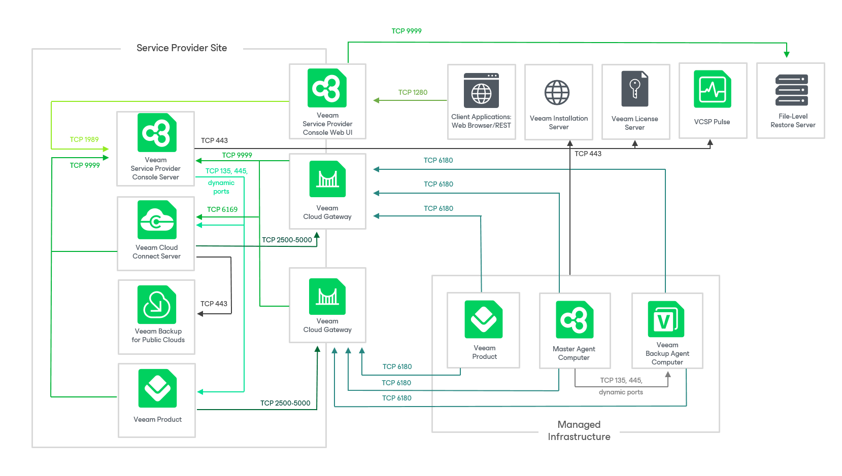

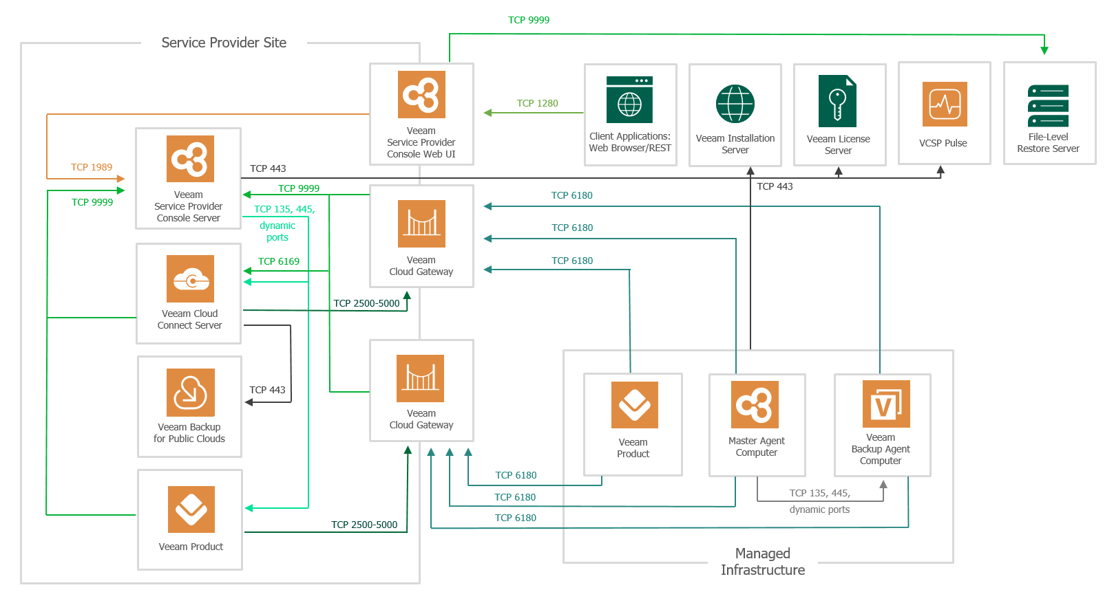

Ports
The following diagram and table describe ports that must be open to ensure that Veeam Service Provider Console components and machines interacting with these components can exchange data.
