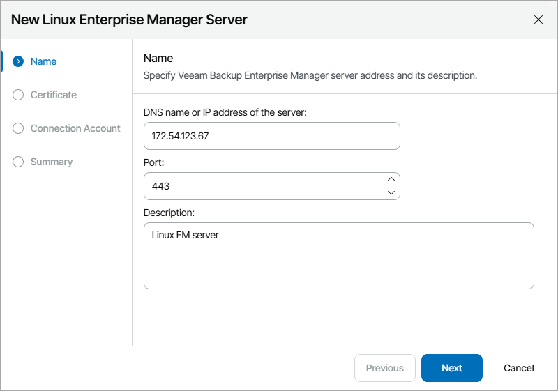

  1. At the Name step of the wizard, specify the following settings:
  1. In the DNS name or IP address of the server field, type FQDN or IP address of the computer where Veeam Backup Enterprise Manager server is deployed.
  2. In the Port field, specify a number of the port that you plan to use to connect to the Veeam Backup Enterprise Manager server. By default, port 443 is used.
  3. In the Description field, type server description or comments.
Specify Server Address

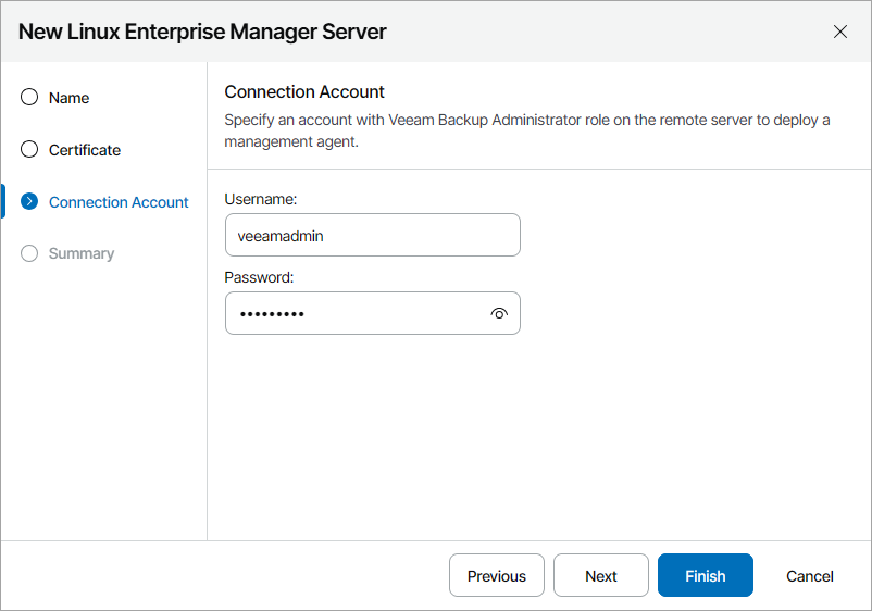

  1. At the Certificate step of the wizard, review the Veeam Backup Enterprise Manager server security certificate.
  2. At the Connection Account step of the wizard, specify credentials of a user account with the Veeam Backup Administrator role on the remote machine.
This account will be used to install a Veeam Service Provider Console management agent on the Veeam Backup Enterprise Manager server.
Specify Connection Account Credentials
