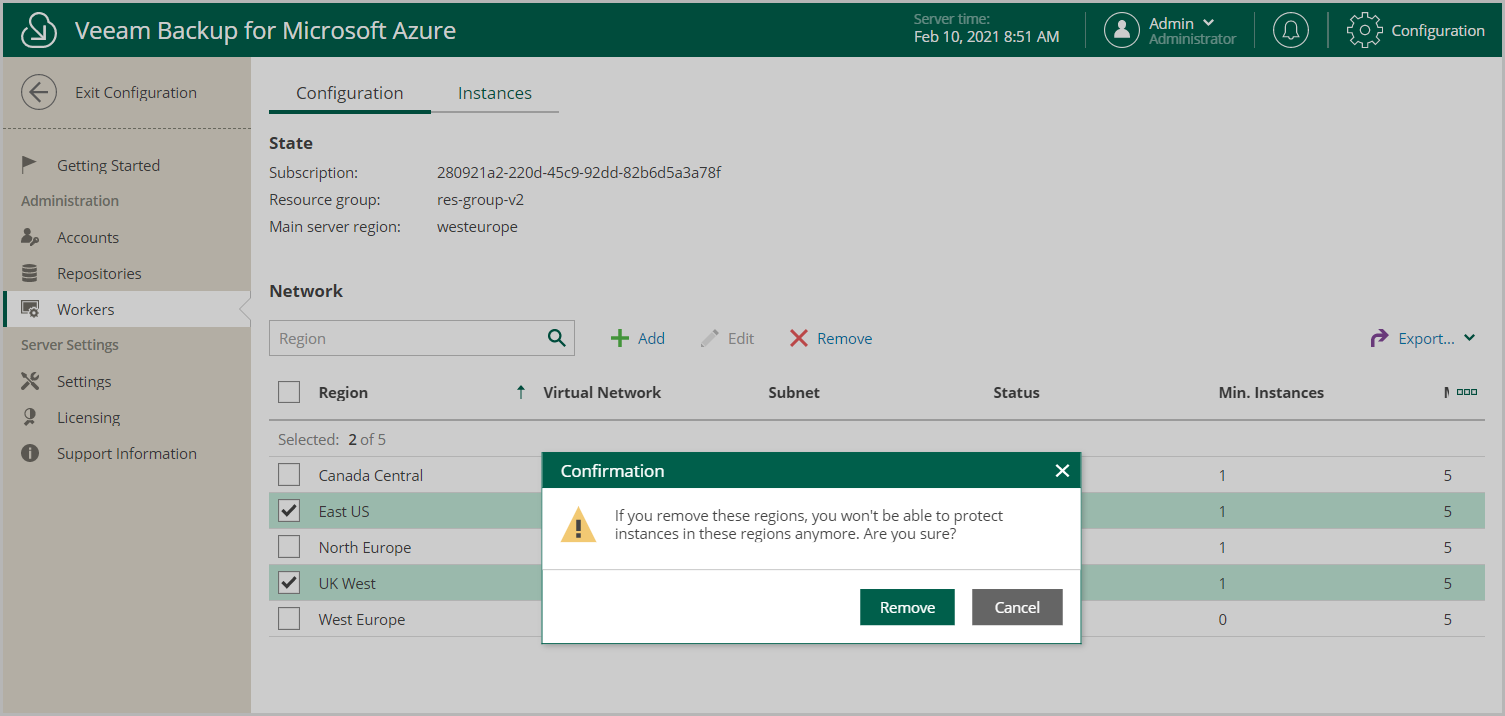

To remove a worker configuration from the backup infrastructure, do the following:
- Switch to the Configuration page.
- Navigate to Workers > Configuration.
- Select the worker configuration and click Remove.
Note |
When you remove a worker configuration, Veeam Backup for Microsoft Azure permanently removes from the backup infrastructure all worker instances that have been created based on this configuration. If there are any worker instances that are currently involved in a backup or restore process, these instances will be removed only when the process completes. |
