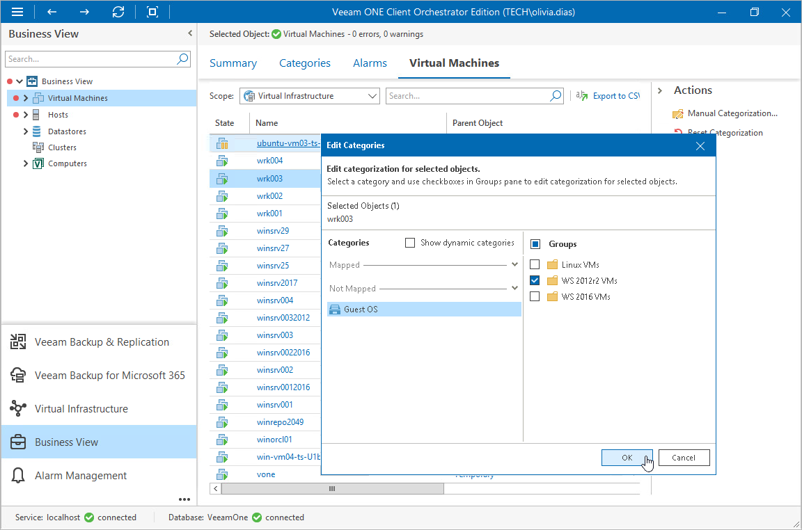

  1. In the Actions pane, click Manual Categorization.
Alternatively, right-click the category and select Manual categorization from the shortcut menu.
  1. In the Edit Categories window, select a category and groups to which you want to add objects.
  2. The Categories section lists static categories to which you can add objects. To display all categories for the selected object type, select the Show Dynamic Categories check box.
  3. Click OK to save the settings.

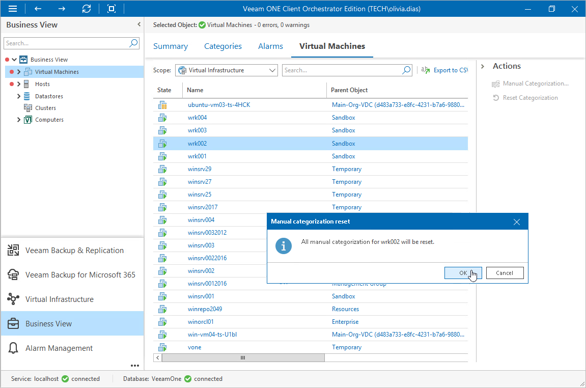

  1. In the Actions pane, click Reset Categorization.
Alternatively, right-click the category and select Reset categorization from the shortcut menu.
  1. In the Manual categorization reset window, click OK to confirm object removal.
If you reset manual categorization for an object that has been manually added to a group included in a plan, this object will be removed from the plan as soon as the plan will acquire the DISABLED mode.
