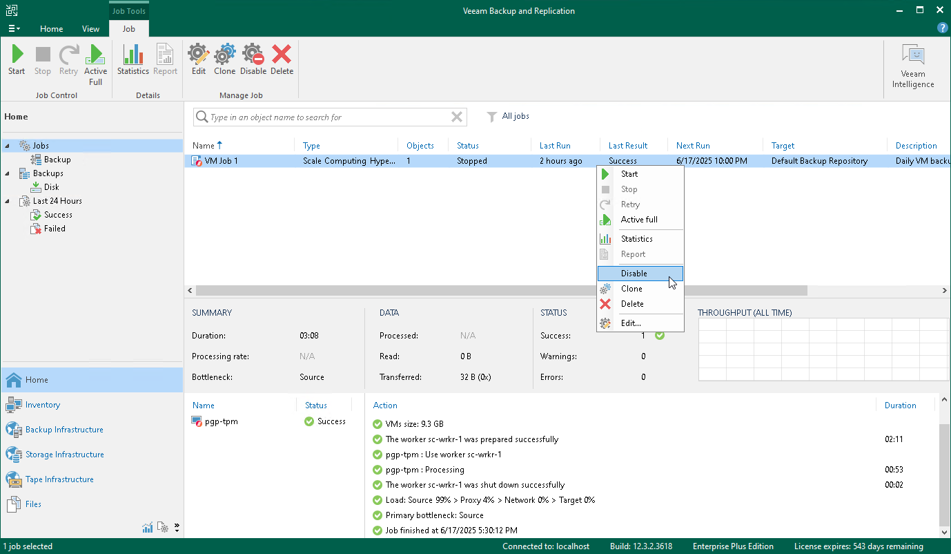

To enable or disable a backup job, do the following:
- Open the Home view.
- In the inventory pane, select Jobs.
- In the working area, select the necessary job and click Enable or Disable on the ribbon.
Alternatively, right-click the job and select Enable or Disable.
