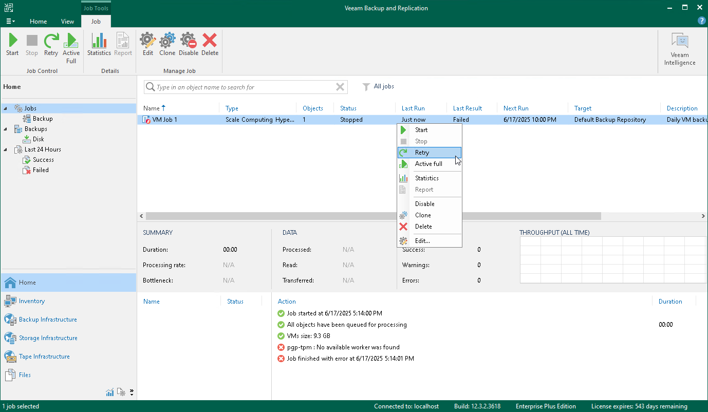

To retry a job, do the following:
- Open the Home view.
- In the inventory pane, select Jobs.
- In the working area, select the necessary job and click Retry on the ribbon.
Alternatively, right-click the job and select Retry.
