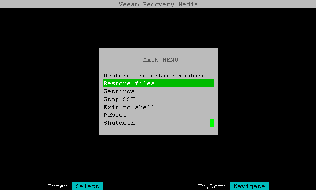

  1. From the main menu of Veeam Recovery Media, select Restore files.
Step 9. Restore Additional Files
The wizard will switch directly to the backup location you previously defined during bare metal recovery.

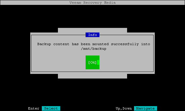

  1. Press [Enter] to mount the backup file. By default, backup content is mounted into the /mnt/backup directory of the recovery image OS file system.
  1. On the confirmation message, select Ok and press [Enter].

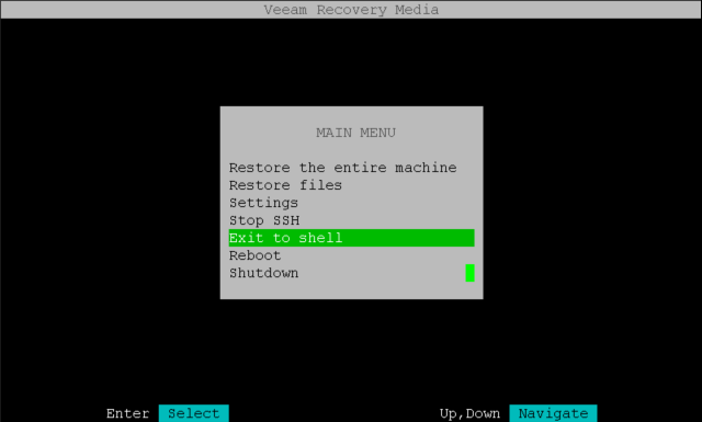

  2. From the main menu, select Exit to shell.
  1. In the terminal, browse to the folder where the backup file was mounted and copy the necessary files and directories to a desired location. For details, see Save Restored Files.
