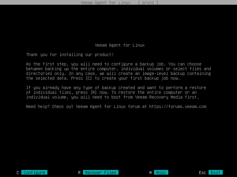

When you launch the Veeam Agent for Linux control panel for the first time, Veeam Agent for Linux offers you to perform initial product setup. To learn more, see Performing Initial Setup.
After you perform initial product setup, before you configure the first backup job, you can use the Veeam Agent for Linux control panel to perform the following operations:
- Configure a new backup job.
- Restore files and folders from existing backup.
- Manage license and product logs.
After you configure one or several backup jobs, you can also use the control panel to start a backup job and work with backup job sessions.
