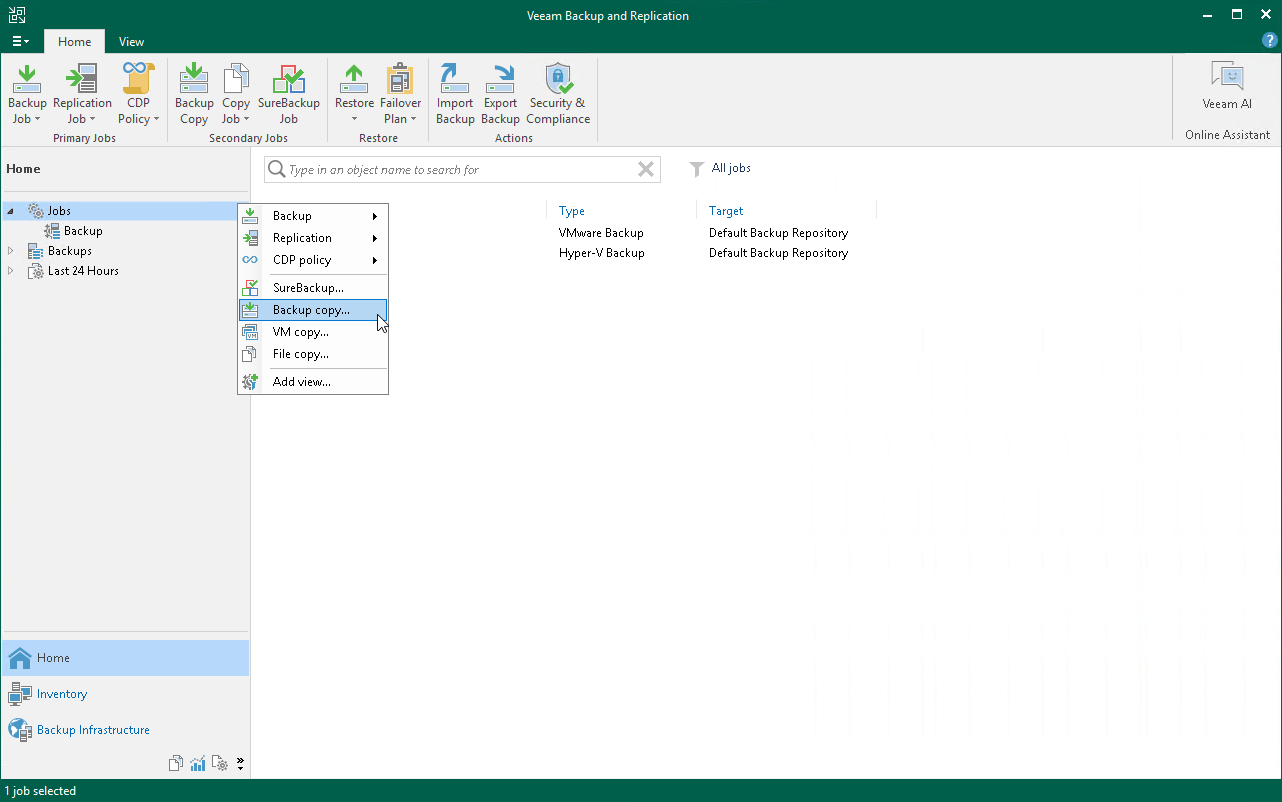

  1. Open the Home view.
  2. In the inventory pane, right-click Jobs and select Backup Copy to launch the New Backup Copy Job wizard.

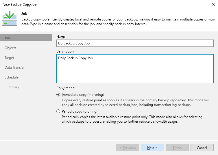

  1. At the Job step of the wizard, do the following:
  1. Specify a name and description for the backup copy job.
  2. In the Copy mode field, check that the Immediate copy is selected.
In the immediate copy mode, Veeam Backup & Replication copies new data as soon as it appears on the source repository. For more information, see Backup Copy Modes in the Veeam Backup & Replication User Guide.

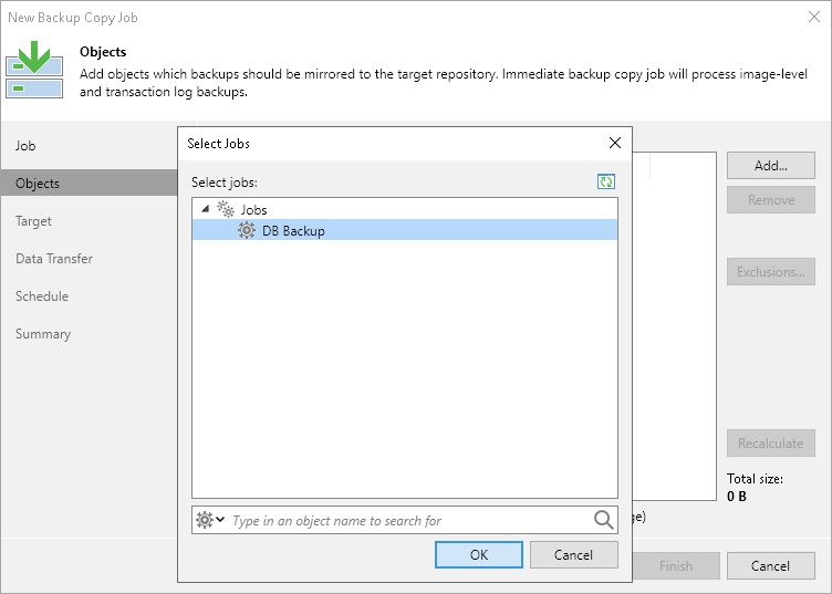

  1. At the Objects step of the wizard, click Add and select backup jobs that you want to copy.
Backup Copy

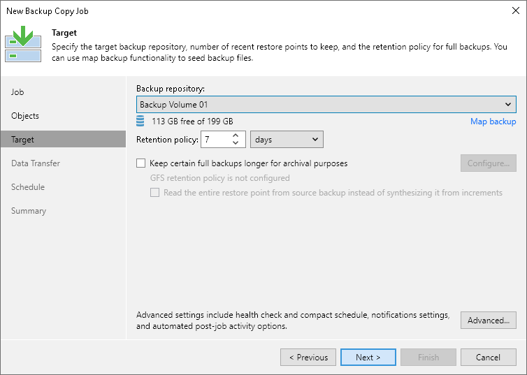

  1. At the Target step of the wizard, select the backup repository where you want to store the backup copy. For other settings, keep the default values.
Backup Copy
