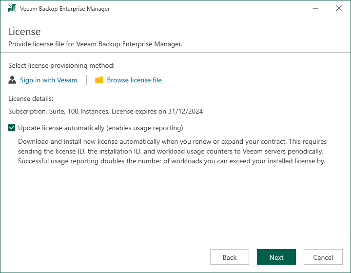

  2. At the Provide License step of the wizard, specify the path to the license key.
If you install Veeam Backup Enterprise Manager on the backup server, you can proceed without providing a license file. In this case, Veeam Backup Enterprise Manager will use the license that is already installed on the backup server.
Provide License

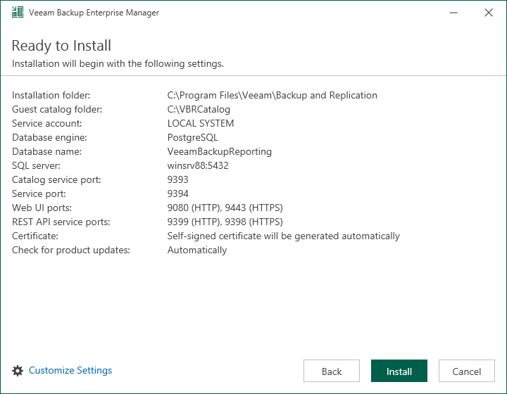

  2. At the Ready to Install step of the wizard, click Install to begin installation.
Check Default Configuration
