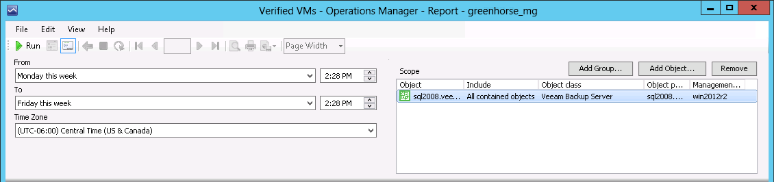

Step 3. Choose Report Scope
Select the backup server to include in the report.
- By default, the Scope section contains the Veeam Backup Server Group. Select the group and click Remove.
- Click Add Group. In the Add Group window, click Options. In the Options window, click Add. In the Class Name search box, type “backup server” and click Search. Select the Veeam Backup Server class in the list of search results, click Add and click OK. In the Options windows, click OK to apply the filter. In the Add Group window, click Search. The search will return a list of objects that belong to the Veeam Backup Server class. Select the server, click Add and click OK.
