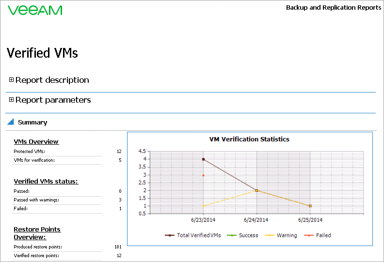

Report Output
The report will display historical data on SureBackup job sessions for the specified reporting period.
The Summary section will provide the following information:
  • Number of protected and verified VMs
  • Latest state of SureBackup job sessions (total number of VMs for which the latest SureBackup session completed successfully, total number of VMs for which the latest SureBackup session completed with warnings and total number of VMs for which the latest SureBackup session failed)
  • Number of produced and verified restore points
Report Output
The Verification Rate chart will show how the number of successfully verified VMs was changing during the reporting period.
In this example, the report shows that there on 23.06.2014 there were 4 verified VMs, 3 VMs for which verification tests failed and 1 VM which verification test passed with warnings. On 24.06.2014, there were 2 verified VMs in total and verification test for all of them passed with warnings. On 25.06.2014, there was 1 verified VMs in total and verification tests for it also passed with warnings. The number of produced restore points during this week was 181, and 12 of them were verified.

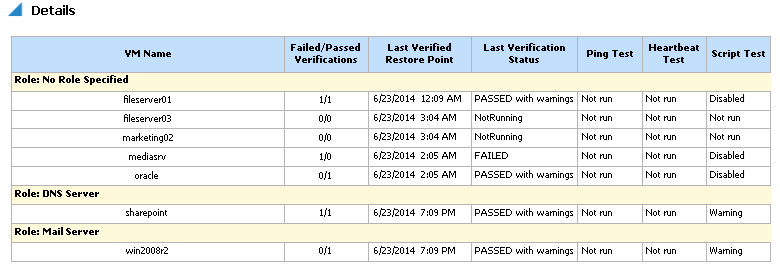

The details table will provide for each VM the result of verification tests run for the VM (in the 'failed/passed' format), the date of the last verified restore point and the result of the latest SureBackup job session.
