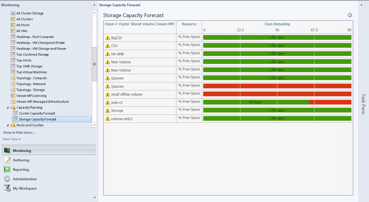

Example screenshot below shows the forecast on the number of days left before the level of free space on storage reaches 5%:
Capacity Planning Dashboard
