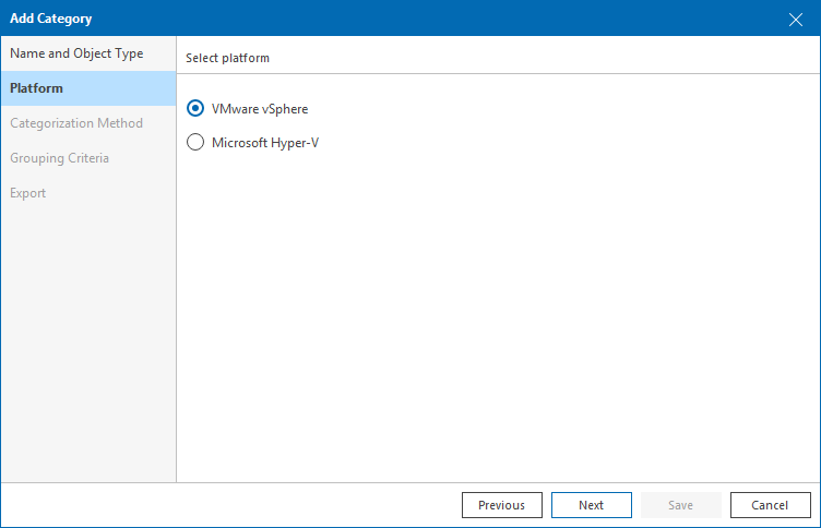

  1. At the Platform step, select the VMware vSphere option.
Category Name and Object Type

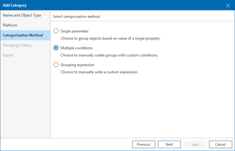

  1. At the Categorization Method step, select the Multiple conditions option.

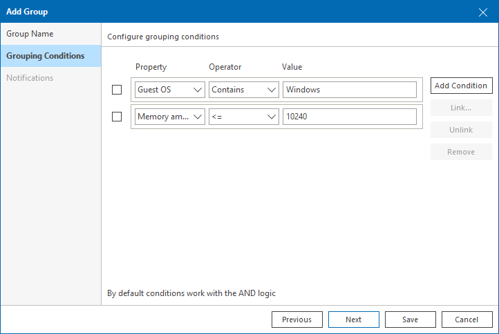

  1. At the Grouping Conditions step, set up the OS condition:
  • From the Property drop-down list, select Guest OS.
  • From the Operator drop-down list, select the Contains.
  • In the Value field, type Windows.
  1. Click Add Condition and set up the RAM conditions:
  • From the Property drop-down list, select Memory amount (MB).
  • From the Operator drop-down list, select <=.
  • In the Value field, type 10240.
Grouping Condition

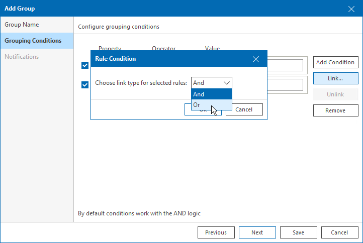

  1. To make both Ubuntu and CentOS VMs fall in one group, you will link these OS conditions. To do that:
  • Select check boxes next to each Guest OS condition.
  • Click Link.
  • In the Rule Condition window, from the Choose link type for selected rules select Or.
Condition Link
