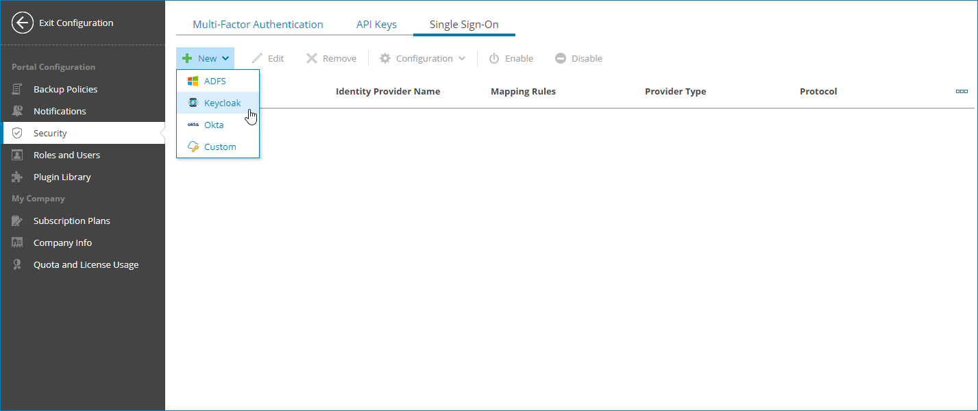

- At the top right corner of the Veeam Service Provider Console window, click Configuration.
- In the configuration menu on the left, click Security.
- On the SIngle Sign-On tab, click New and select an identity provider service from the drop-down list.
The identity provider configuration wizard will open.

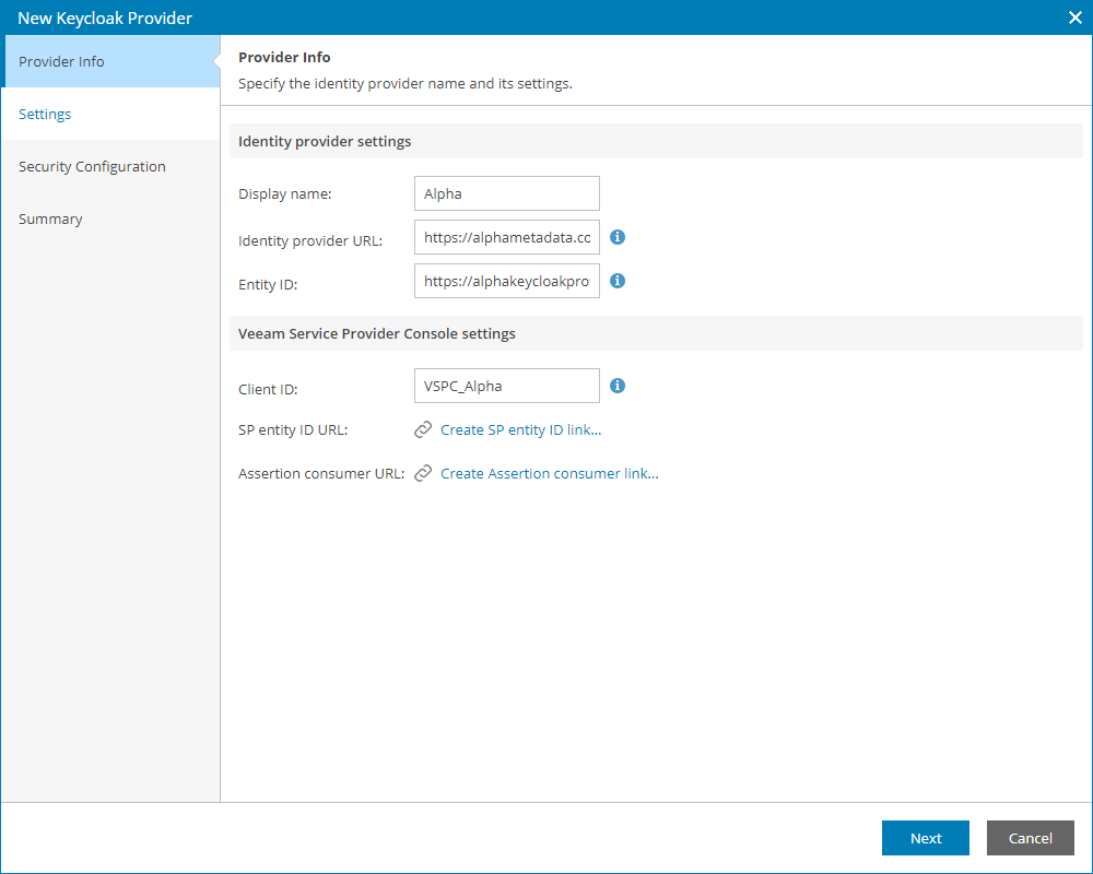

- In the Display name field, specify the IdP name that will be displayed in the IdP list on the Single Sing-On tab.
- In the Identity provider URL field, specify URL of the page containing metadata that is required by IdP.
- [For Okta, Keycloak and Custom identity providers] In the Entity ID field, specify the unique identifier that an IdP will use to identify SP.
- In the Client ID field, specify the name of the client created for Veeam Service Provider Console on the IdP side.
Note that the name must be at least 5 and not more than 32 characters long and must not contain special characters.
- [For Okta, Keycloak and Custom identity providers] Click SP entity ID link to generate entity ID URL based on the portal web address and the Client ID value.
If you apply changes to Client ID value after link generation, click New link.
- [For Okta, Keycloak and Custom identity providers] Click Create Assertion consumer link to generate assertion consumer service URL based on the portal web address and the Client ID value.

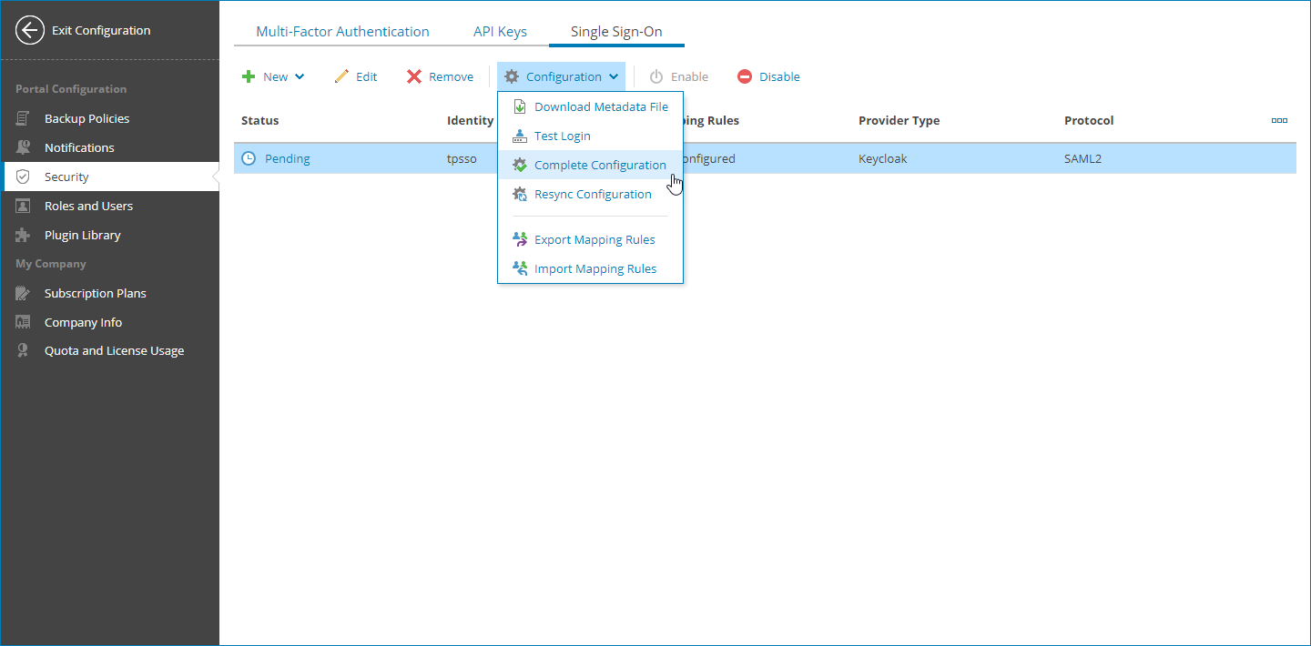

- Select the new identity provider in the list.
- From the Configuration drop-down list, select Complete Configuration.
If you have mapping rules configured, you can also select Test Login. It allows you to perform a trial authorization. If it is successful, the identity provider configuration is completed automatically.

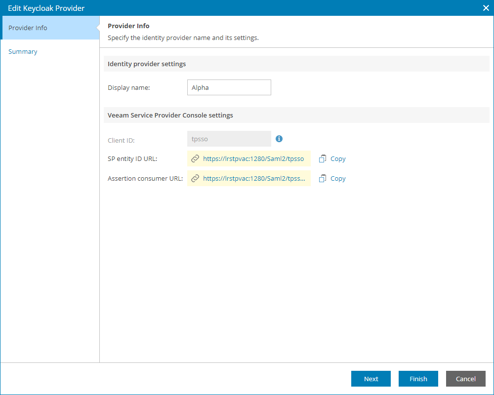

Editing Identity Provider Display Name
To edit an identity provider:
- Open the Single Sign-On tab.
- Select the identity provider in the list.
- At the top of the list, click Edit.
Alternatively, you can right-click the necessary identity provider and choose Edit.
The Edit Identity Provider wizard will open.
- In the Display name field, specify a new IdP display name.
- Click Finish.

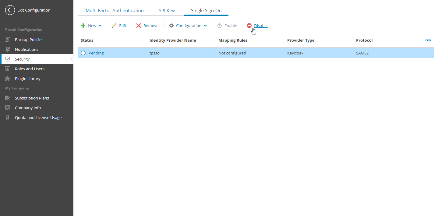

Disabling Identity Providers
Although you can add multiple identity providers, only one of them can be enabled at the same time. If you add a second identity provider, you cannot complete its configuration until another identity provider is enabled. To disable an identity provider:
- At the top of the list, click Disable.
Alternatively, you can right-click the necessary identity provider and choose Disable.

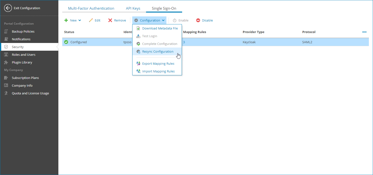

Updating Identity Provider Configuration
You can update IdP configuration saved in Veeam Service Provider Console. This can be useful if changes were applied to a profile on IdP server and IdP configuration in Veeam Service Provider Console must be synchronized with these changes.
To update IdP configuration:
- From the Configuration drop-down list, select Resync Configuration.
Alternatively, you can right-click the necessary identity provider, choose Configuration and select Resync Configuration.

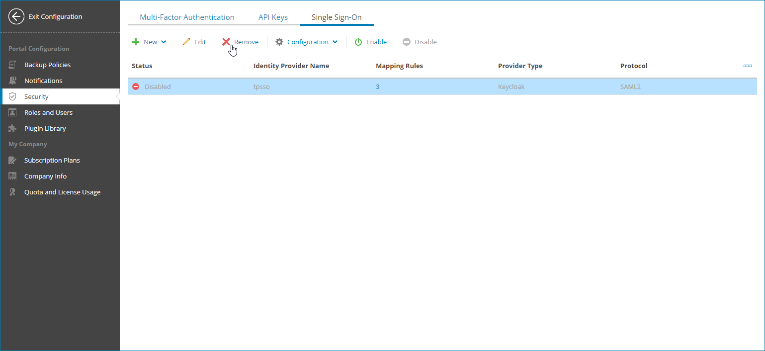

Deleting Identity Providers
To delete an identity provider:
- At the top of the list, click Remove.
Alternatively, you can right-click the necessary identity provider and choose Remove.
After you delete an identity provider, all user identities associated with it will also be deleted.
