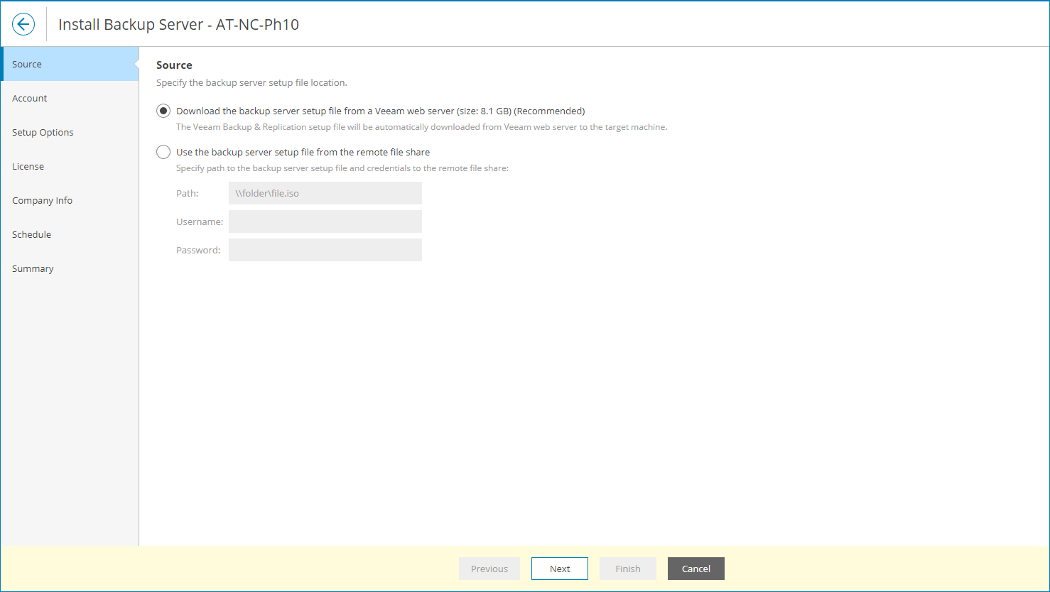

- At the Source step of the wizard, specify location of the Veeam Backup & Replication distribution:
- To use a latest distribution from Veeam Installation Server (over the Internet), select the Download the backup server setup file from a Veeam web server option.
- To use a distribution stored on a remote file share, select the Use the backup server setup file from the remote file share option and specify remote file share location and credentials of an account that Veeam Service Provider Console will use to connect to the file share.

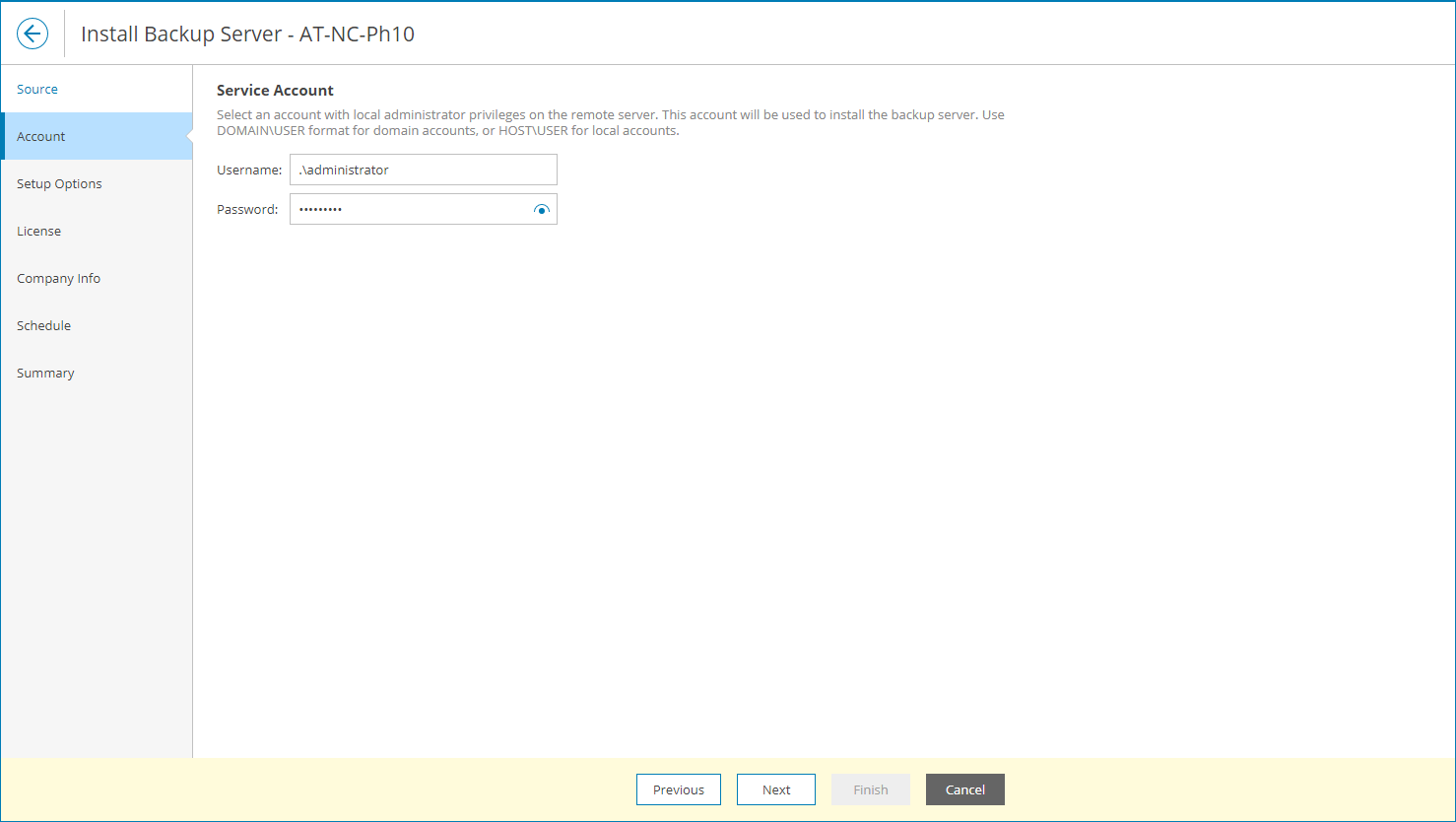

- At the Account step of the wizard, specify service account credentials. The account must have local administrator permissions on the remote computer.

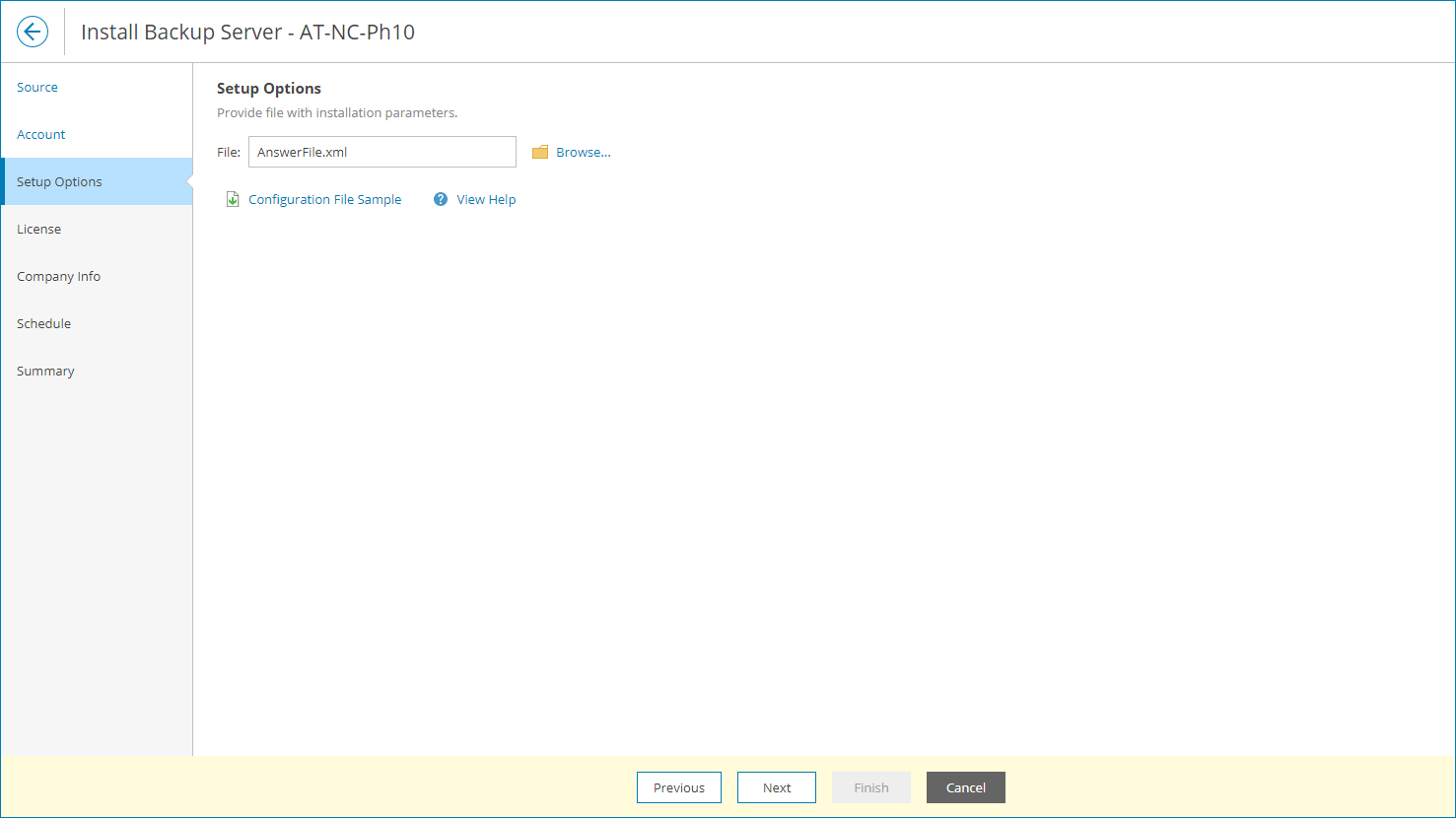

- At the Setup Options step of the wizard, specify path to an XML file with installation parameters.
To create a configuration file, click Configuration File Sample to download the file template and fill in the necessary configuration parameters. For details on configuration parameters, see Configuration Parameters.

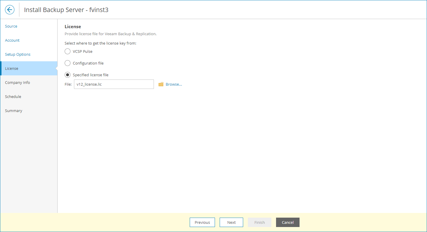

- At the License step of the wizard, do one of the following:
- To install license key configured in VCSP Pulse, select VCSP Pulse.
This option is available only if you have configured integration with VCSP Pulse. For details, see Integration with VCSP Pulse.
If this option is selected, the VCSP Pulse step will become available in the wizard.
- To install license provided in configuration file, select Configuration file.
- To upload license file from your computer, select Specified license file, click Browse and specify a path to the license file.

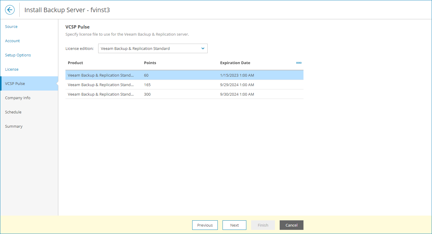

- [If you have selected VCSP Pulse at step 9] At the VCSP Pulse step of the wizard, select the necessary license key in the list.
It is not recommended to install one VCSP Pulse license in multiple products. If you have selected a license key that is already installed in another product and your service provider has enabled license management for your company, Veeam Service Provider Console will ask you to copy the license key. If you do not want to copy the license key, you can download the license file from VCSP Pulse and install it manually. Note that in license usage report Veeam Service Provider Console will add up points usage for all servers with the same license ID.

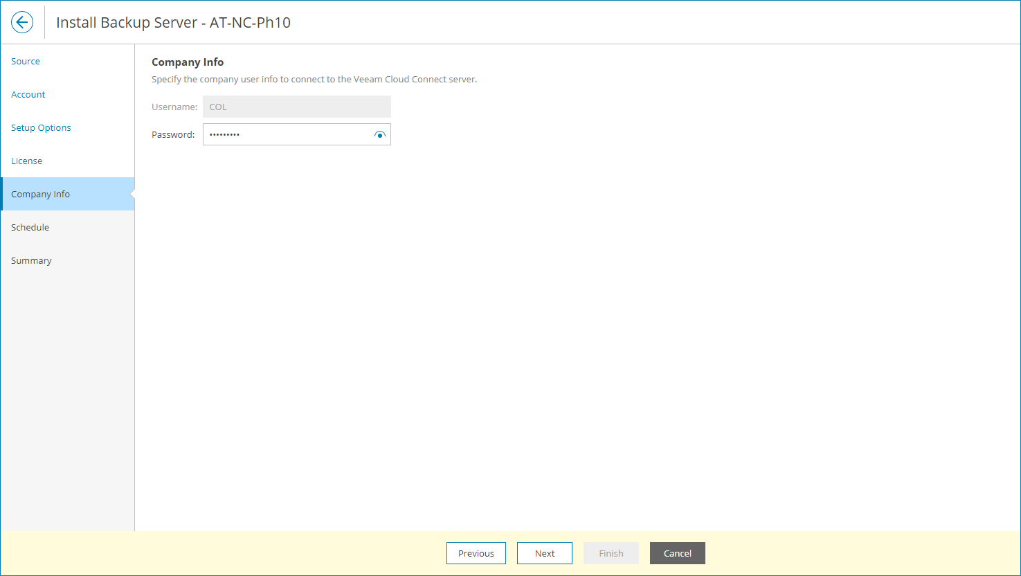

- At the Company Info step of the wizard, specify password for the Veeam Cloud Connect tenant account (for Native Veeam Cloud Connect tenant accounts) or credentials for the VMware Cloud Director organization administrator account (for VMware Cloud Director tenant accounts).

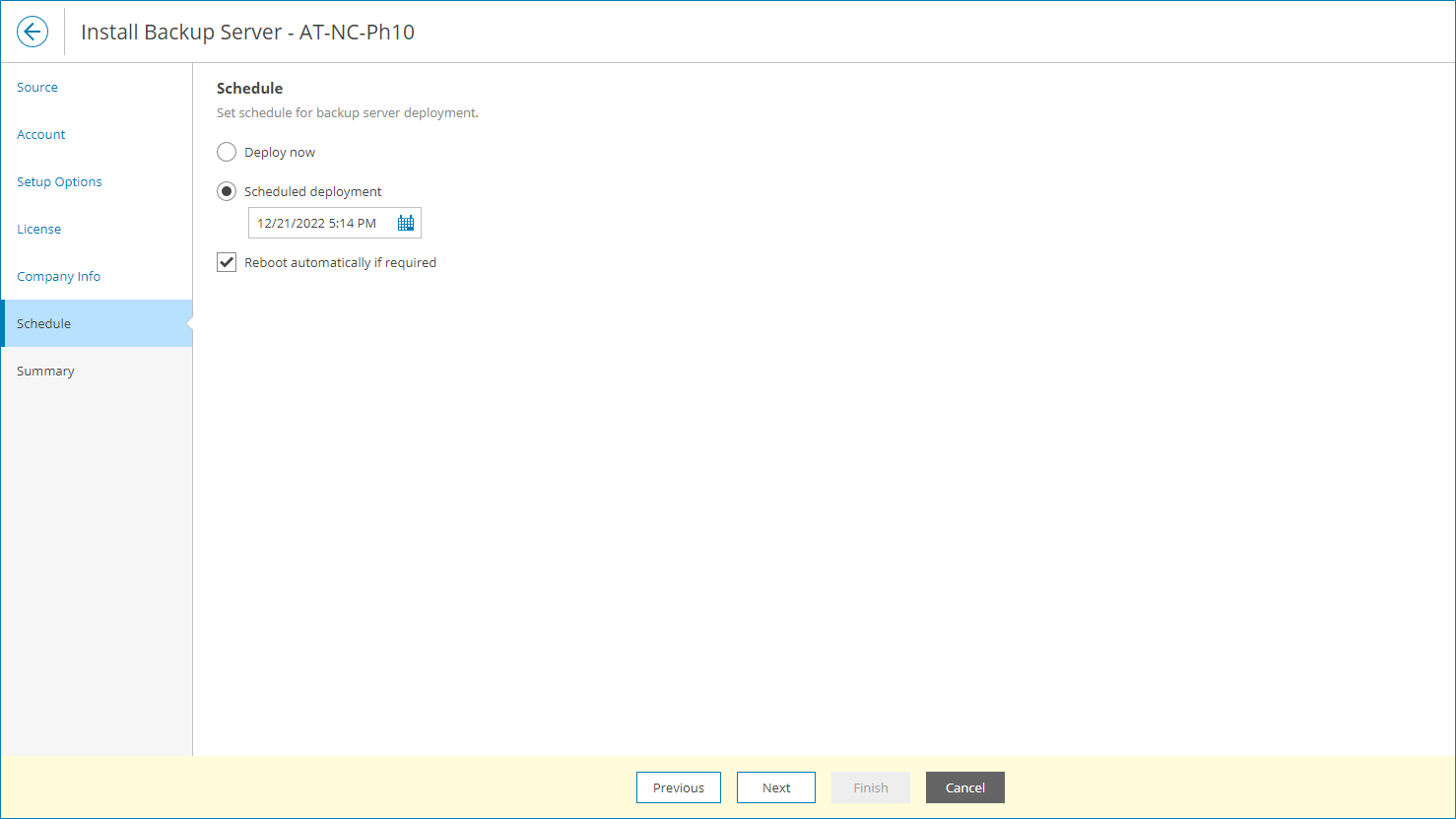

- At the Schedule step of the wizard, specify when you want to install Veeam Backup & Replication:
- To install Veeam Backup & Replication immediately, select Deploy now.
- To postpone installation, select Scheduled deployment and specify date and time when Veeam Backup & Replication will be installed.
You will be able to reschedule or cancel the installation using the link in the Scheduled Deployment column on the Discovered Computers tab.
If you want to reboot remote computers automatically during Veeam Backup & Replication installation, select the Reboot automatically if required check box. If you do not select the check box, you may need to reboot the backup server manually to complete installation. For details, see Rebooting Remote Computers.

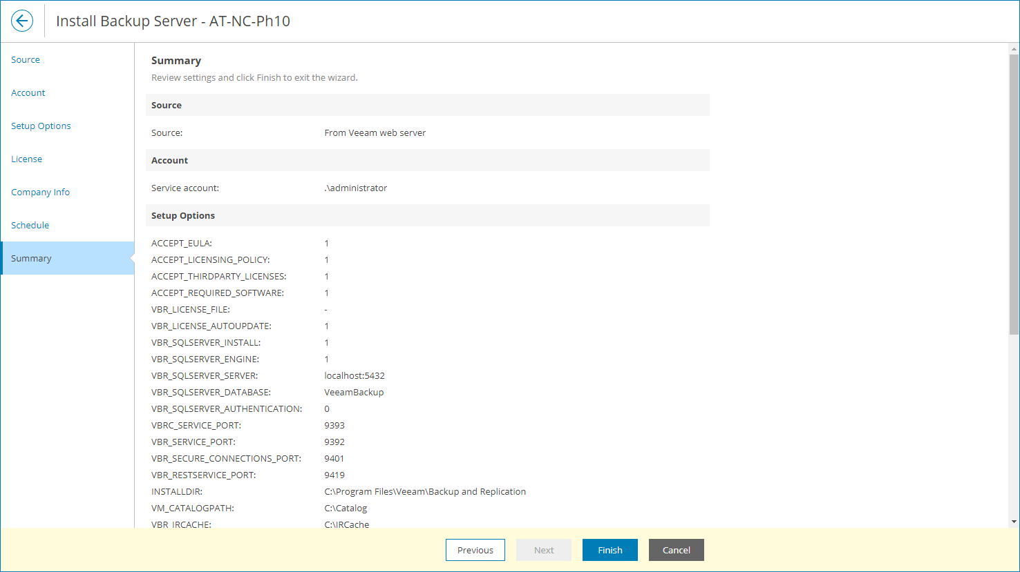

- At the Summary step of the wizard, review installation settings and click Finish.
