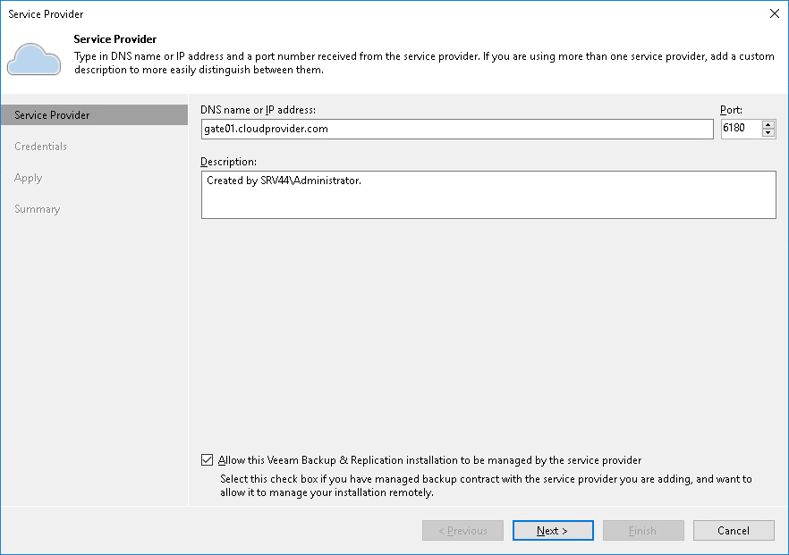

  1. At the Service Provider step of the wizard, configure the following settings:
  1. In the DNS name or IP address field, specify DNS name or IP address of a cloud gateway.
This can be any cloud gateway deployed on the service provider side.
  1. In the Description field, specify description of the service provider.
  2. In the Port field, specify the port on the cloud gateway that is used to transfer backup data to the cloud.
The default port number is 6180, and can be customized when a cloud gateway is deployed.
  1. Select the Allow this Veeam Backup & Replication installation to be managed by the service provider check box.
When this check box is selected, Veeam Backup & Replication deploys a Veeam Service Provider Console management agent on a backup server. The management agent is downloaded from Veeam Service Provider Console.
If you do not select this check box, Veeam Service Provider Console will not collect any data from this Veeam Backup & Replication server. This server will not be displayed in the Veeam Service Provider Console portal and you will not be able to perform any management actions for this server from Veeam Service Provider Console.
You must specify credentials of the Company Tenant communicated to you by the service provider.
  1. Follow the remaining steps of the wizard. At the last wizard step, click Finish.
