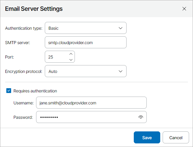

To configure SMTP server settings:
  2. In the configuration menu on the left, click Server Settings and navigate to Email Server.
  3. Click the SMTP server status link.
The Email Server Settings window will pop out.
  1. From the Authentication type list, select Basic.
  2. In the SMTP server field, specify an FQDN or IP address of the SMTP server.
  3. If required, change the SMTP communication port in the Port field.
By default, Veeam Service Provider Console uses port 25 for communication with the SMTP server.
  1. From the Encryption protocol list, select the necessary encryption protocol (Auto, None (not secure), SSL on connect, StartTLS, StartTLS when available).
  2. If the SMTP server requires authentication, select the Requires authentication check box and specify authentication credentials in the Username and Password fields.
  3. Click Save.

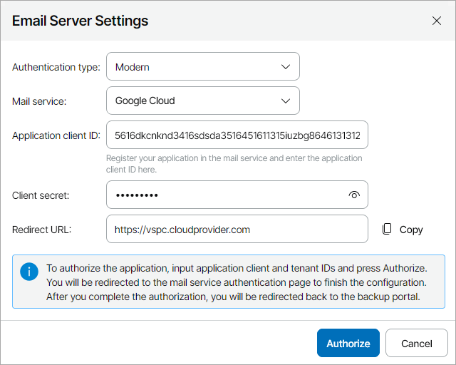

To configure mail service integration:
  1. From the Authentication type list, select Modern.
  2. From the Mail service list, select your mail service provider (Google Cloud, Microsoft Azure, Microsoft Azure (US Goverment), Microsoft Azure (China), Microsoft Azure (Germany)).
  3. In the Application client ID, Client secret and Tenant ID (for Microsoft Azure authentication) fields, specify Veeam Service Provider Console identification parameters in the mail service.
  4. In the Redirect URL field, check the URL address under which Veeam Service Provider Console must be registered in the mail service.
You can copy the specified URL to register Veeam Service Provider Console in the mail service.
  1. Click Authorize.
You will be redirected to your mail service provider page. After you complete the authentication, you will be redirected to Veeam Service Provider Console portal and the mail server settings will be saved automatically.

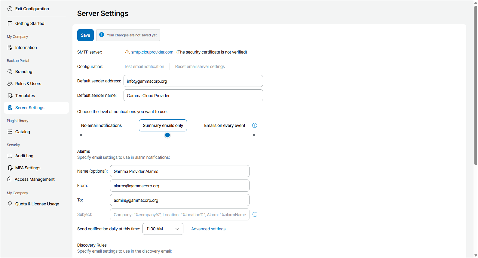

Configuring Notification Frequency Settings
You can specify notification frequency settings for the following types of email notifications:
  • Alarm notifications
Note that alarms triggered on Veeam ONE servers will not be included in the email notifications.
  • Summary notifications for discovery rules
  • Billing notifications
You can choose how often you want to receive email notifications:
  3. Make sure you have specified SMTP server settings as described in Configuring SMTP Server Settings.
  4. In the Default sender address field, specify the default address that will be displayed in the From field in the notifications sent by Veeam Service Provider Console.
  5. In the Default sender name field, specify the default sender name that will be displayed in the From field in the notifications sent by Veeam Service Provider Console.
  6. Use the slider or click the option name to select notification frequency:
  • No email notifications
Select this option if you do not want to receive email notifications about triggered alarms and discovery results. Veeam Service Provider Console will use the address specified in your company profile to deliver welcome emails to client companies, subtenant creation emails, invoices and reports that you send manually using product web UI.
Note that subtenant creation emails will be sent only for automatically created subtenants. For details, see Automatic Creation of Subtenants.
  • Summary emails only
Select this option if you want to receive daily email notification with information about discovery results for all rules for the past 24 hours and all triggered alarms. Billing and report notifications to companies will be sent automatically after invoices and scheduled reports are generated.
  • Emails on every event
Select this option if you want to receive notifications for each triggered alarm, every discovery rule, and customize the subject of email notifications. Billing and report notifications to companies will be sent automatically after invoices and scheduled reports are generated.

  1. At the top of the page, click Save.
Configure Notification Settings
