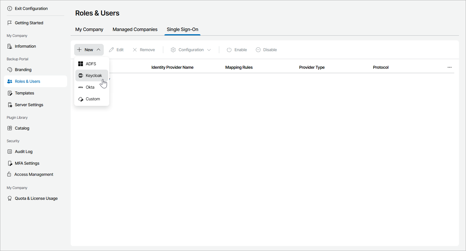

  2. In the configuration menu on the left, click Roles & Users.
  3. On the Single Sign-On tab, click New and select an identity provider service from the drop-down list.
The identity provider configuration wizard will open.

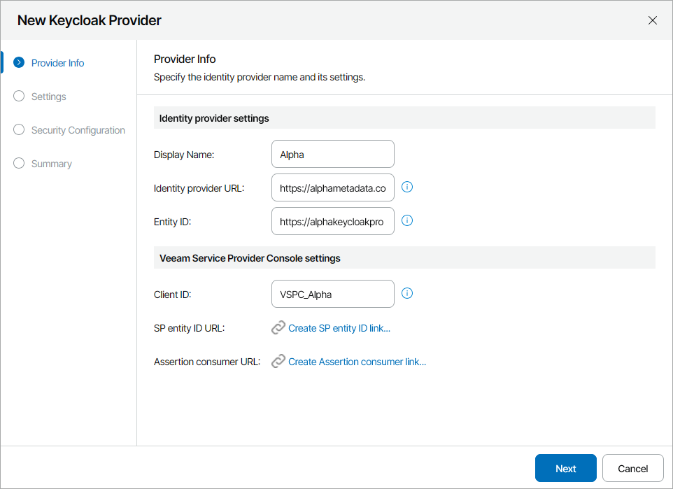

Provider Info
  1. At the Provider Info step of the wizard, specify general information on the IdP:
  • In the Display name field, specify the IdP name that will be displayed in the IdP list on the Single Sign-On tab.
  • In the Identity provider URL field, specify URL of the page containing metadata that is required by IdP.
  • [For Okta, Keycloak and Custom identity providers] In the Entity ID field, specify the unique identifier that an IdP will use to identify SP.
  • In the Client ID field, specify the name of the client created for Veeam Service Provider Console on the IdP side.
Note that the name must be at least 5 and not more than 32 characters long and must not contain special characters.
  • [For Okta, Keycloak and Custom identity providers] Click SP entity ID link to generate entity ID URL based on the portal web address and the Client ID value.
If you apply changes to Client ID value after link generation, click New link.
  • [For Okta, Keycloak and Custom identity providers] Click Create Assertion consumer link to generate assertion consumer service URL based on the portal web address and the Client ID value.

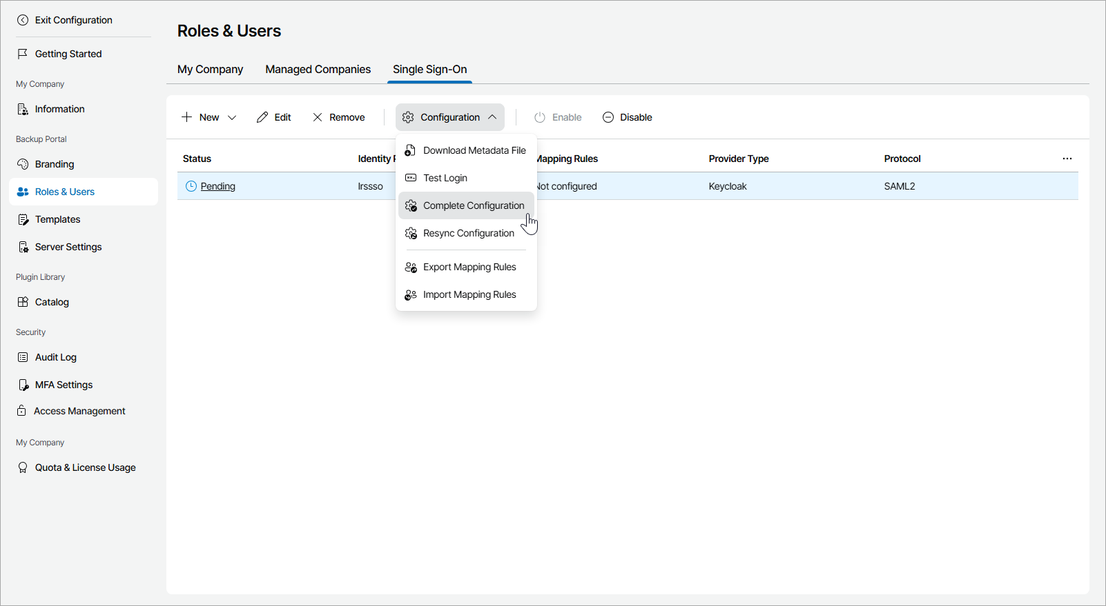

  1. Select the new identity provider in the list.
  2. From the Configuration drop-down list, select Complete Configuration.
If you have mapping rules configured, you can also select Test Login. It allows you to perform a trial authorization. If it is successful, the identity provider configuration is completed automatically.

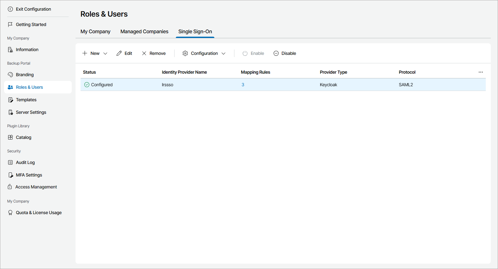

Viewing Identity Provider Details
To view details on configured identity providers:
  3. Open the Single Sign-On tab.
Each identity provider in the list is described with the following set of properties:
  • Status — status of the IdP.
  • Identity Provider Name — display name of the IdP.
  • Mapping Rules — mapping rules configured for the IdP.
  • Provider Type — name of the IdP service.
  • Protocol — authentication protocol.
