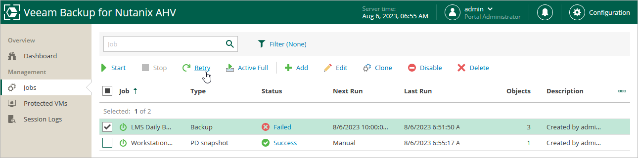

To retry a job, do the following:
  1. Navigate to Jobs.
  2. Select the failed job.
  3. Click Retry.
Retrying Job
You can also retry a job using the Veeam Backup & Replication console. To do that, in the inventory pane of the Home view, select Jobs > Backup, select the job and click Retry on the ribbon.
