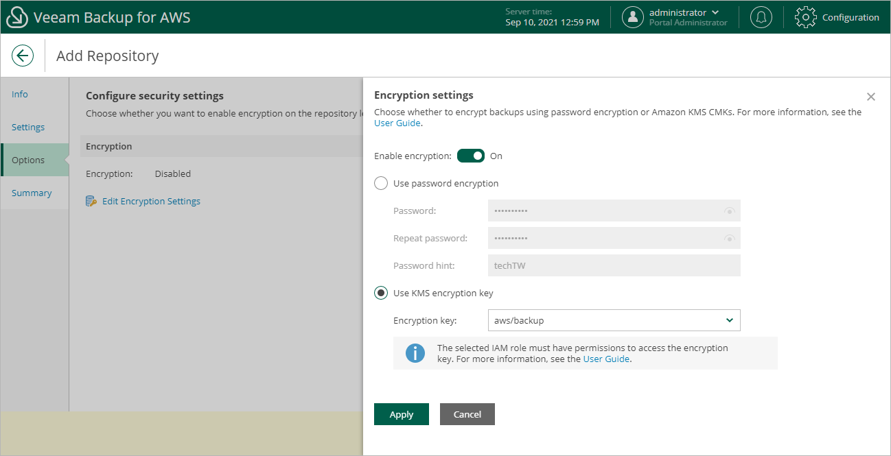

To enable encryption for the backup repository, do the following:
- Click Edit Encryption Settings.
- In the Encryption settings window, set the Enable encryption toggle to On.
- Choose whether you want to use a password or an AWS Key Management Service (KMS) key to encrypt the backed-up data. For more information on encryption algorithms, see Backup Repository Encryption.
- To use password encryption, select the Use password encryption option and specify a password that will be used to encrypt data.
- To encrypt data using AWS KMS keys, select the Use KMS encryption key option and choose a KMS key from the Encryption key drop-down list.
For a KMS key to be displayed in the list of available encryption keys, it must be created in the AWS Region where the selected Amazon S3 bucket is located, and the IAM role specified to access the bucket must have permissions to the key. For more information on permissions required for the IAM role, see Repository IAM Role Permissions.
