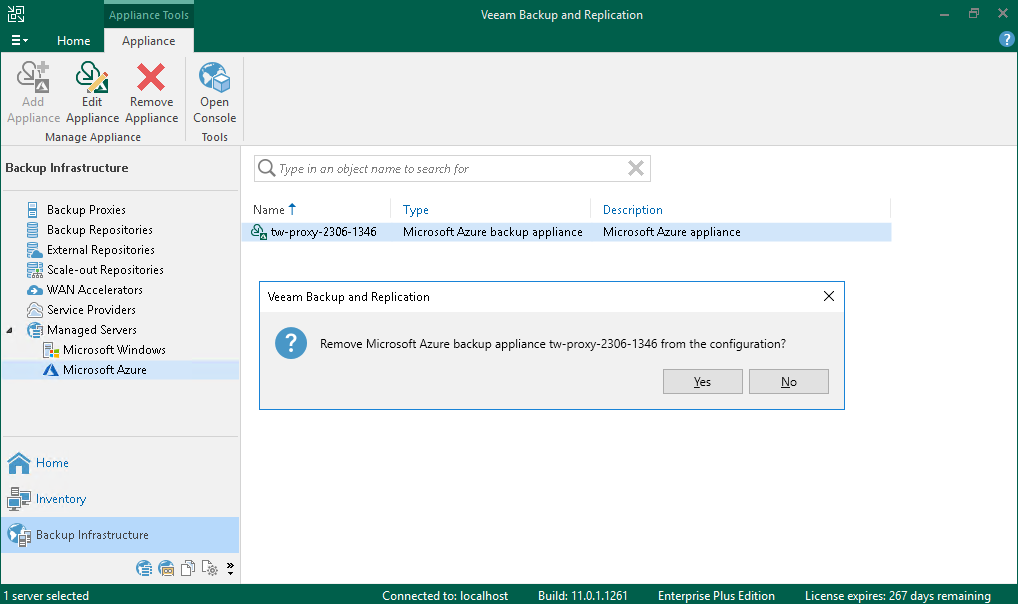

To remove an appliance from the Veeam Backup & Replication infrastructure:
  2. In the inventory pane, select Managed Servers.
  3. In the working area, select the appliance that you want to remove, and click Remove Appliance on the ribbon. Alternatively, right-click the appliance and select Remove.
  4. In the opened window, click Yes. If you see the Remove associated resources from cloud infrastructure check box, make sure that it is not selected.
Remove appliance
