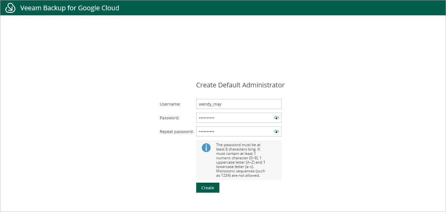

  1. Create the Default Administrator account whose credentials you will use for your first login to Veeam Backup for Google Cloud.
To increase the security of the Default Administrator account, it is recommended that you enable multi-factor authentication (MFA) for the account after you first log in to Veeam Backup for Google Cloud. To learn how to enable MFA, see Enabling Multi-Factor Authentication.

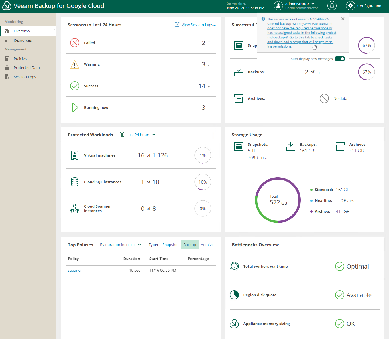

  1. Log in to Veeam Backup for Google Cloud with the credentials of the Default Administrator account as described in section Accessing Veeam Backup for Google Cloud.
You will receive a warning in the notification area notifying that the service account created during product installation does not have the permissions required to perform data protection tasks for the project to which the backup appliance belongs. You can grant the missing permissions to the service account later when configuring Veeam Backup for Google Cloud as described in section Managing Projects and Folders.
