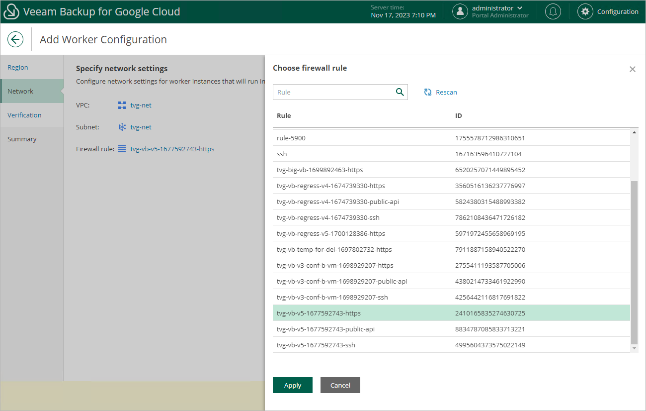

  1. Select a firewall rule that will be used to access worker instances deployed based on the configuration during file-level recovery operations.
For a firewall rule to be displayed in the list of available rules, it must be created in the Google Cloud console as described in Google Cloud documentation.
  • The selected firewall rule must allow direct network traffic to Google Cloud resources. Proxy redirect and setting a proxy in the Veeam Backup for Google Cloud configuration are not supported.
  • If you plan to perform file-level recovery, the selected firewall rule must allow HTTPS traffic to all VM instances on the specified VPC network. To learn how to create firewall rules that allow HTTPS connections, see Google Cloud documentation.
