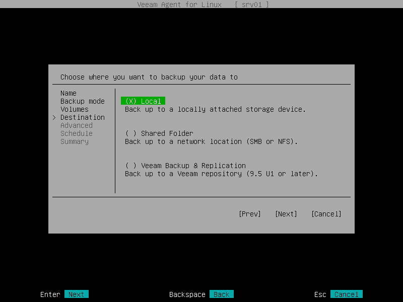

At the Destination step of the wizard, select a target location for the created backup.
You can select one of the following options:
- Local — select this option if you want to save the backup on a removable storage device attached to the computer or on a local computer drive. With this option selected, you will pass to the Location step of the wizard.
- Shared Folder — select this option if you want to save the backup in a network shared folder. With this option selected, you will pass to the Network step of the wizard.
- Veeam Backup & Replication — select this option if you want to save the backup on a backup repository managed by the Veeam backup server. With this option selected, you will pass to the Veeam step of the wizard.
