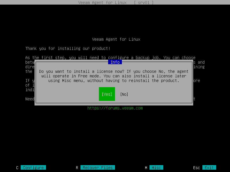

When you launch the Veeam Agent for Linux control panel for the first time, Veeam Agent for Linux displays a welcome screen with the short product description and a notification window offering to install a license. You can install the license immediately or perform this operation later. To learn more, see Veeam Agent for Linux Licensing.

In the Veeam Agent for Linux control panel, the use of a mouse is not supported. To start an operation, you need to use a specific key on your keyboard. For example, you can press the 'c' key to start the backup job configuration, press the 's' key to start a backup job or press the 'r' key to start the file-level restore process. Short help information on the currently available operations and keys is displayed at the bottom of the control panel.
