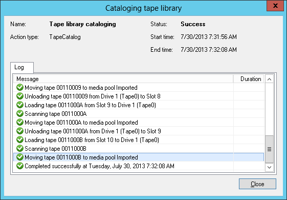

The catalog log will display job session results. To access the catalog session details, you can open the History view and locate the necessary session under the Jobs > Tape node.
