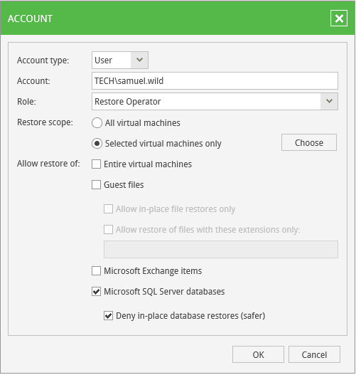

Delegating Restore Rights via Enterprise Manager
If you plan to delegate rights to perform database restore operations to personnel in charge, you need to assign an Enterprise Manager role to them and configure its settings accordingly:
- Log in to Enterprise Manager with administrative rights, go to Configuration tab.
 - To create a role for restore operator, follow the steps described in the Configuring Security Settings section of the Veeam Backup Enterprise Manager User Guide.
 - To allow for database restore, make sure the Microsoft SQL Server databases checkbox is selected for restore operator’s account in the Account dialog.
 - If you need to prevent restore operators from overriding production databases at restore, select the Deny in-place database restores (safer) check box.
Authorized users will be able to log in to Enterprise Manager and access the Items tab with database restore commands and options.
