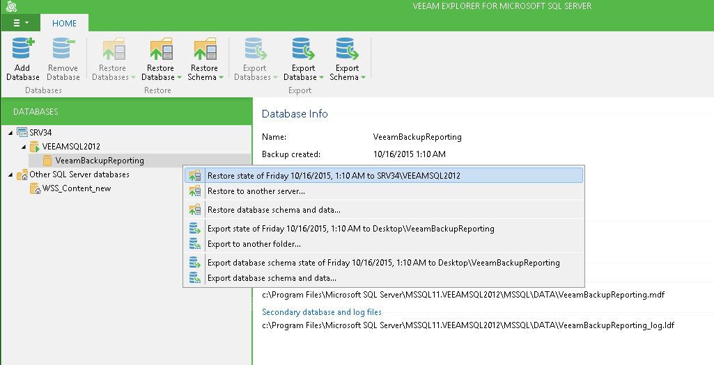

To launch 1-Click Restore from Veeam Explorer, select the required database in the navigation tree on the left, then select Restore Database > Restore <current_state_date> to <server>\<instance> from the toolbar or from the node’s shortcut menu:
You can also restore multiple databases at once – for that, select the required server or instance in the navigation tree on the left, then:
- If restoring multiple databases of the selected SQL Server, select Restore <current_state> to <server_name> - in this case, all databases will be restored to corresponding instances on that (original) server.
 - If restoring multiple databases of the selected instance, select Restore <current_state> to <server_name>\<instance_name> - in this case, all databases will be restored to the specified instance on the original server.

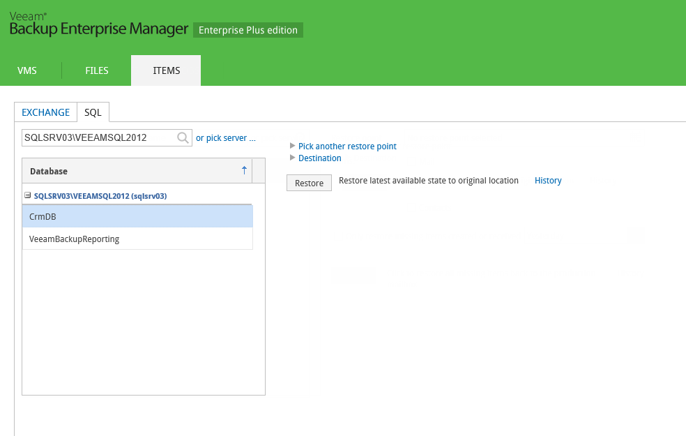

If you are to launch 1-Click Restore in Enterprise Manager:
- Log in to Enterprise Manager with sufficient rights, then on the Items tab click SQL.
- Enter the name of SQL Server hosting the database you need to restore; use the server_name\instance_name format. Alternatively, click the link to pick server from the list of available SQL Server VM backups.
 - Select the database you need and click the Restore button.
