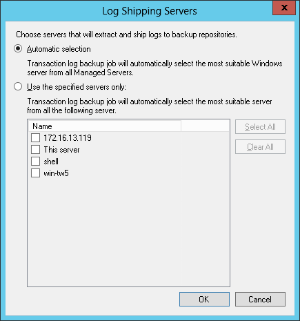

 - Alternatively, if it is not possible to establish direct connection, you can configure Veeam Backup & Replication to use a Microsoft Windows host added to the backup Infrastructure as a log shipping server. You can select server(s) from the list, or instruct Veeam Backup & Replication to automatically choose an optimal log shipping server from the Managed Servers (that is, added to backup infrastructure in Veeam backup console). The choice will be based on two criteria: possible data transfer method(s) and network availability.

You may not want some of your busy managed hosts to participate in the process – if so, use manual server selection when assigning the role of log shipping servers. It is also recommended that you have not only one dedicated Windows host for log shipment, but also a redundant host for availability purposes.  |
Veeam Backup & Replication automatically re-detect available hosts, so if a log shipping server fails for some reason, processing will be performed by another server.
