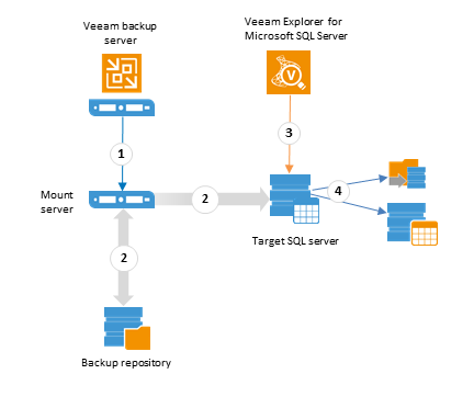

Veeam Backup & Replication also offers a convenient tool to extend the set of restore options – Veeam Explorer for Microsoft SQL Server, installed together with Veeam Backup & Replication server or standalone console as a part of Veeam setup. This tool helps you to restore databases from the SQL Server image-level backup to the original or different location, without a need to recover the whole server VM. The basic restore procedure includes the following steps:
- The backup administrator uses Veeam Backup & Replication restore options to mount database files from the SQL Server's backup, making database hierarchy available for browsing and search.
 - Veeam Explorer for Microsoft SQL Server obtains SQL Server hierarchy information (instances and databases) and presents it to user, facilitating browsing and search. A user selects and follows the necessary database restore scenario.

- Finally, the database is ‘re-created’ on the target Microsoft SQL Server and becomes ready for use. If the export scenario was used, exported database can be then attached to the SQL Server you need.
