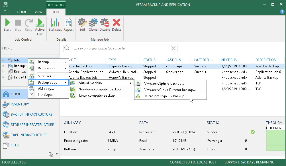

- In the inventory pane, right-click Jobs and select Backup Copy > Virtual machine > Microsoft Hyper-V backup to launch the New Backup Copy Job wizard.

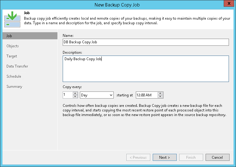

- Specify a name and description for the backup copy job.
- In the Copy every field, specify the duration and beginning of the backup copy interval.

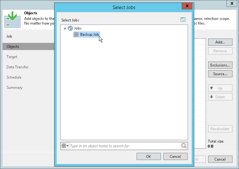

- At the Objects step of the wizard, click Add and select From jobs. In the list of jobs, select the backup job that you want to copy.

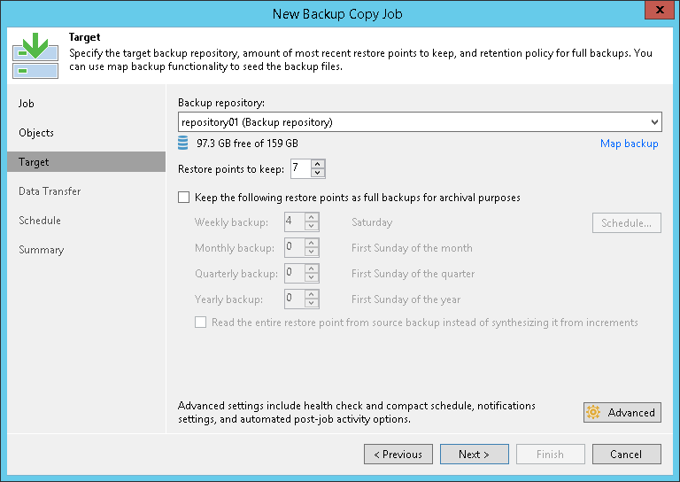

- At the Target step of the wizard, select the backup repository where you want to store the backup copy. For other settings, keep the default values.
