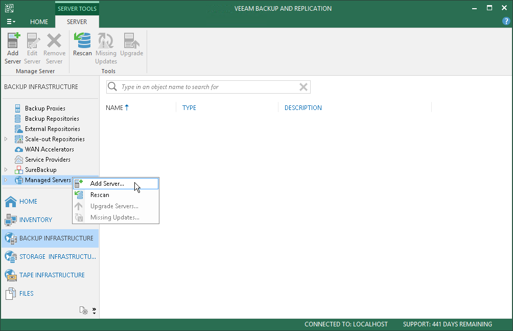

  1. In the inventory pane of the Backup Infrastructure view, right-click the Managed Servers node and select Add Server.

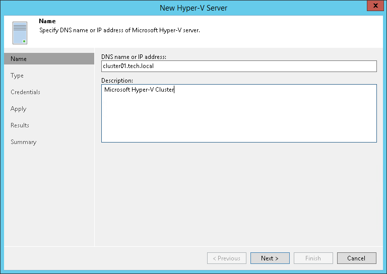

  1. In the Add Server window, click Microsoft Hyper-V > Hyper-V to launch the New Hyper-V Server wizard.
  2. At the Name step of the wizard, specify the DNS name or IP address of the server.

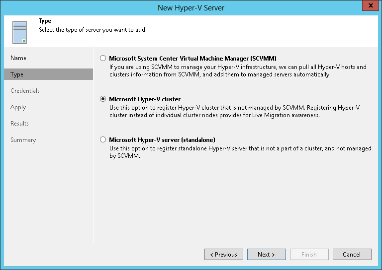

  1. At the Type step of the wizard, select the server type that you want to add.
