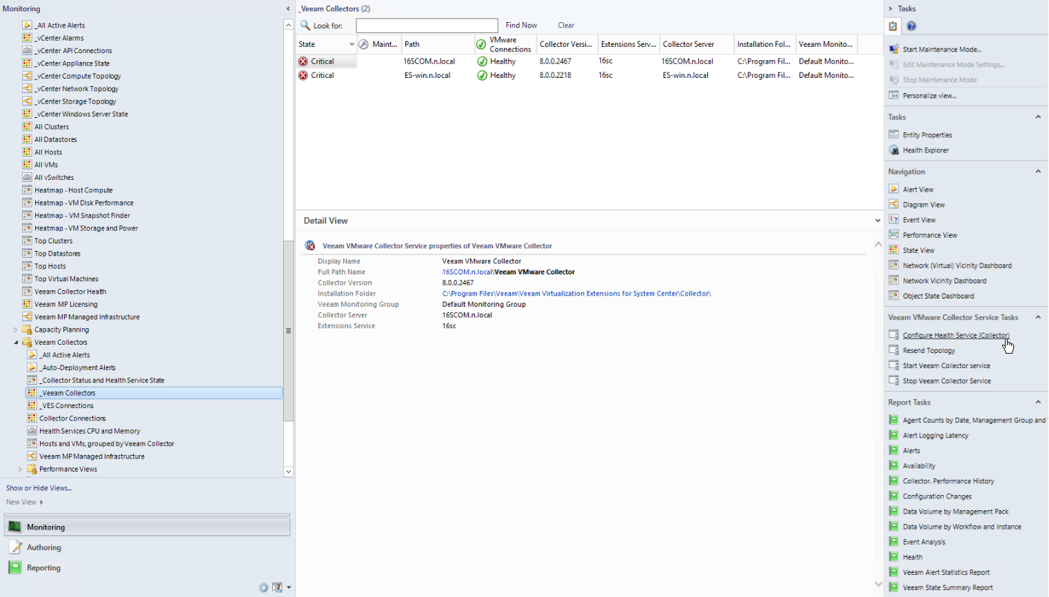

Solution: Run the Configure Health Service task as follows:
In the Monitoring view, open the Veeam for VMware > Veeam Collectors > _Veeam Collectors node.
After discovery of Collector applications is complete in OpsMgr, you will see the _Veeam Collectors view populated with the Collectors.
If the view is empty, you should wait for discovery to complete.
Alternatively, restarting the System Center Management service on the Collector server can be used to trigger discovery.
Configure Health Service Task
Then do the following:
  1. In the Actions pane, expand Veeam VMware Collector Service Tasks and click the Configure Health Service task (outlined in red above).
  2. Run this task against the Collector. Tasks may be run simultaneously. The task will cause the System Center Management service to restart.
Successful task output should look like the one below:
