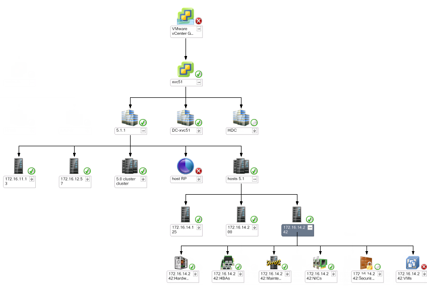

In normal operation, the _vCenter Compute Topology in OpsMgr shows a connected vCenter Server and its child objects (datacenters, clusters and vSphere hosts) similar to the hierarchy below.
vCenter Compute Topology before Failover

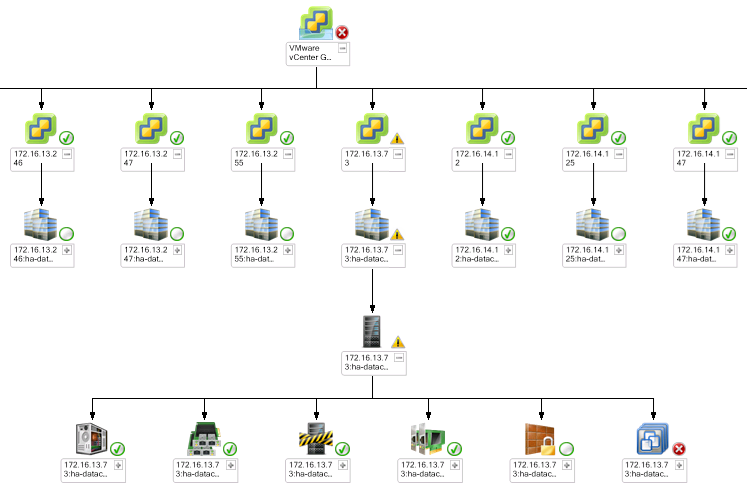

Veeam MP for VMware then rediscovers the VMware topology of hosts and VMs, and monitoring will continue. The _vCenter Compute Topology in OpsMgr illustrates the new connection method, with multiple direct-to-host connections replacing the failed vCenter Server connection:
vCenter Compute Topology after Failover

  • The rebuilt topology will not contain vSphere clusters and datastore clusters, as these are vCenter Server artifacts and are not available when the vCenter Server is offline. Only vSphere hosts, VMs, Distributed Virtual Switches and Standard vSwitches will be displayed.
  • VMs will be re-discovered with a new ID, as the vSphere API used when connecting direct to hosts does not provide the same ID as a vCenter Server connection. This will result in VMs being re-discovered effectively as ‘new’ VMs in OpsMgr terms.
Note however that the display name for such VMs in OpsMgr will be the same — only the underlying Operations Manager ID will be different. This will be transparent for normal monitoring situations, but some gaps may be visible in historical reporting once the vCenter Server is restored and failback has occurred.
  • Datastore monitoring for direct-to-host connections is disabled by default. When a failover occurs, datastore monitoring is disabled for directly-connected hosts due to limitations in the host API, which reports shared datastores as multiple duplicate datastores for every host connection. The performance metrics for such datastores are inaccurate, as individual hosts are not aware of other host activities on shared storage. This duplication of datastores can also cause the monitoring load on Collectors and the OpsMgr system to increase significantly.
For these reasons, datastore monitoring is automatically disabled by default for direct-to-host connections and it is not recommended to enable it when using the vCenter Connection Failover feature.
