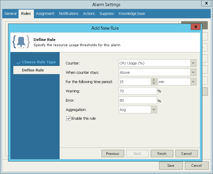

To add a rule for a specific condition or state change:
- On the Rules tab, click Add.
- At the Choose Rule Type step of the wizard, select Rule for specific conditions or state.
- Click Next and select the necessary rule condition.
Available options depend on the alarm type. For the full list of alarm rules, see Appendix B. Alarm Rules.
- At the Define Rule step of the wizard, specify conditions (or other settings, as applicable) for the alarm rule.
- Specify alarm severity.
For details, see Alarm Severity.
- If you want to put the rule in action for the alarm, make sure that the Enable this rule check box is selected.
If you unselect this check box, the rule settings will be saved, but the rule will be disregarded.
- Click Finish.
